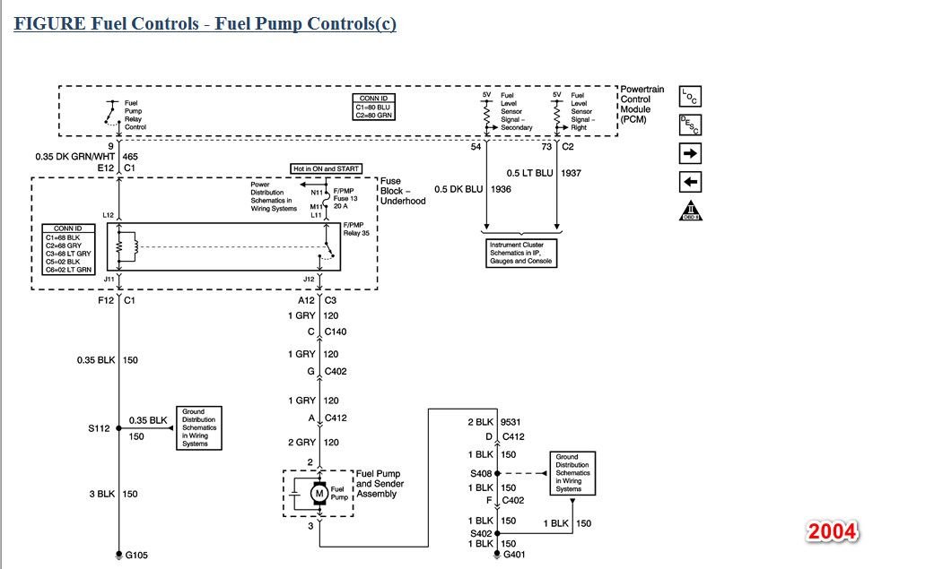

Hello
I'm looking to swap the fuel tanks from my crashed 04 Z into my 99 base race car and wanted to know if the wiring harness is the same or if there are differences in the wiring?
Will I have to use the wiring from my 04 along with the fuel tanks?
Many thanks

The pumps, filters and senders are all different.

Yes, but is the wiring/plugs diferent?

Here it is
