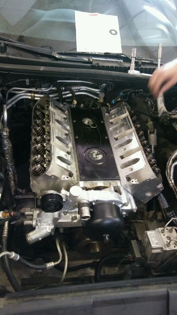

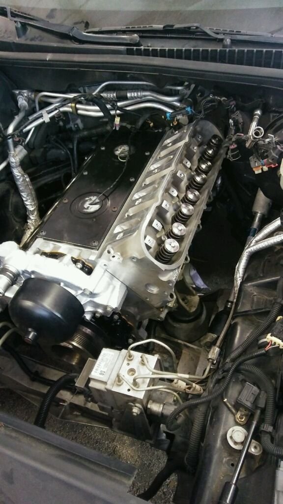

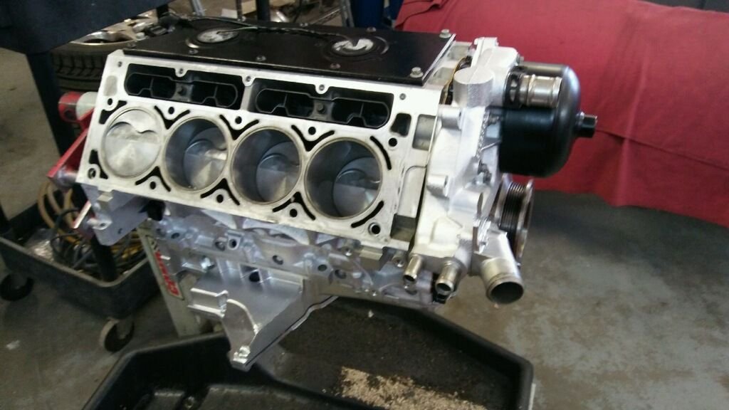

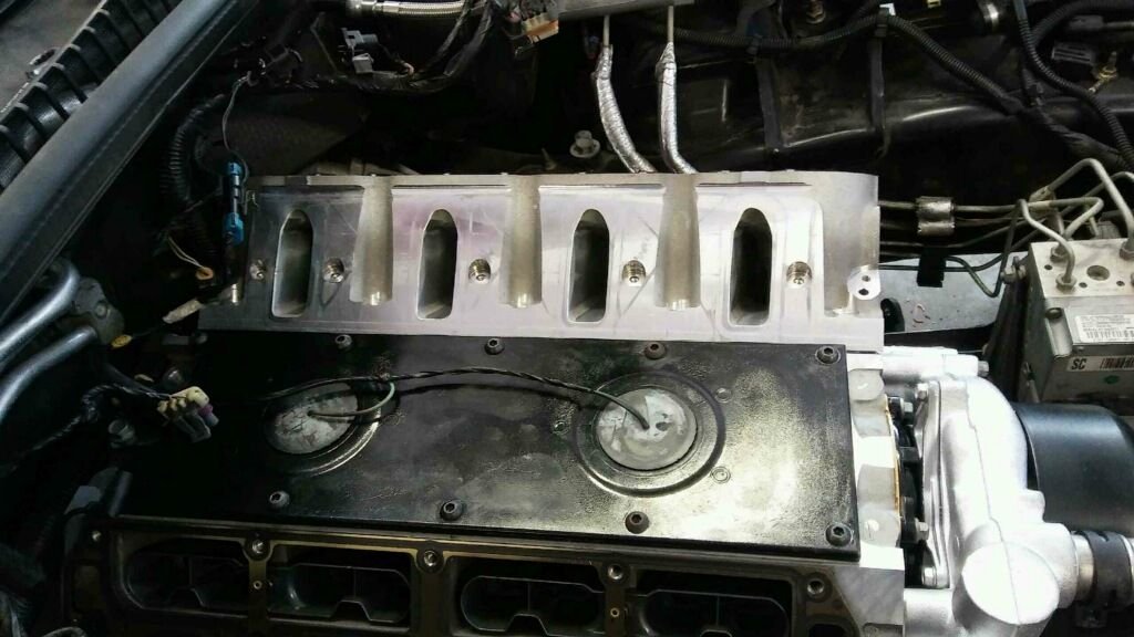

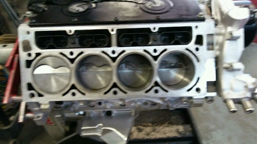

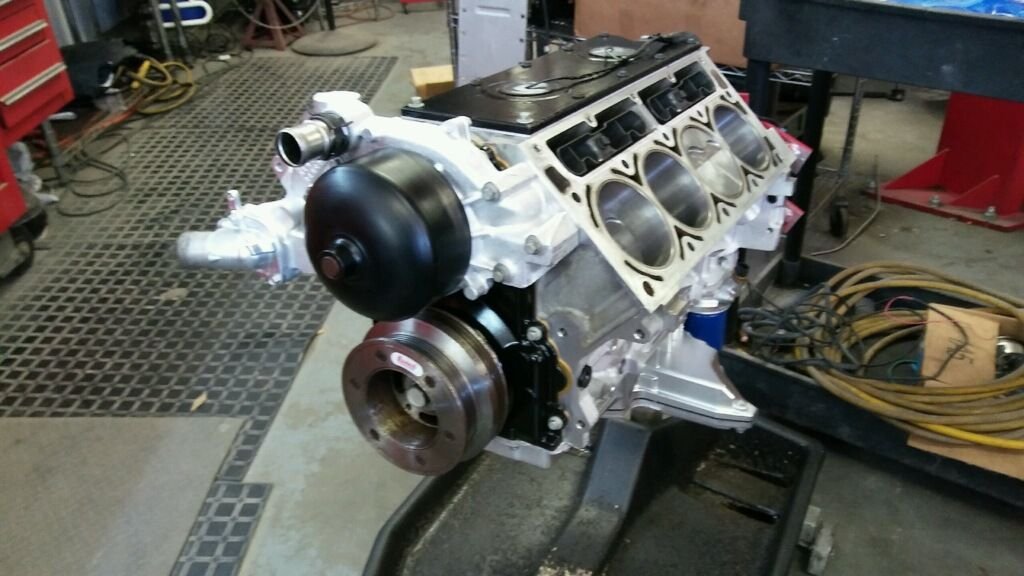

Default Rebuilt engine pics
In the car, heads installedm
Getting close.
Short block, forged pistons.
Short block.
On the car.
Short block.
One head installed, knock sensors.
Old May 5, 2019 | 02:31 PM
  #39
motogib1's Avatar
motogib1
Joined: Feb 2007
Posts: 3,194
Likes: 10
From: New Smyrna Beach Florida
So, the engine should be ready to start next week. As you can see, everything looks brand new on the engine which is a nice side affect. Should be a very stout engine once it is broken in. It has forged pistons and ls3 rods. Will update once it is started. Have to drive 1000 miles before the car iz run wixe open onnthe dyno.

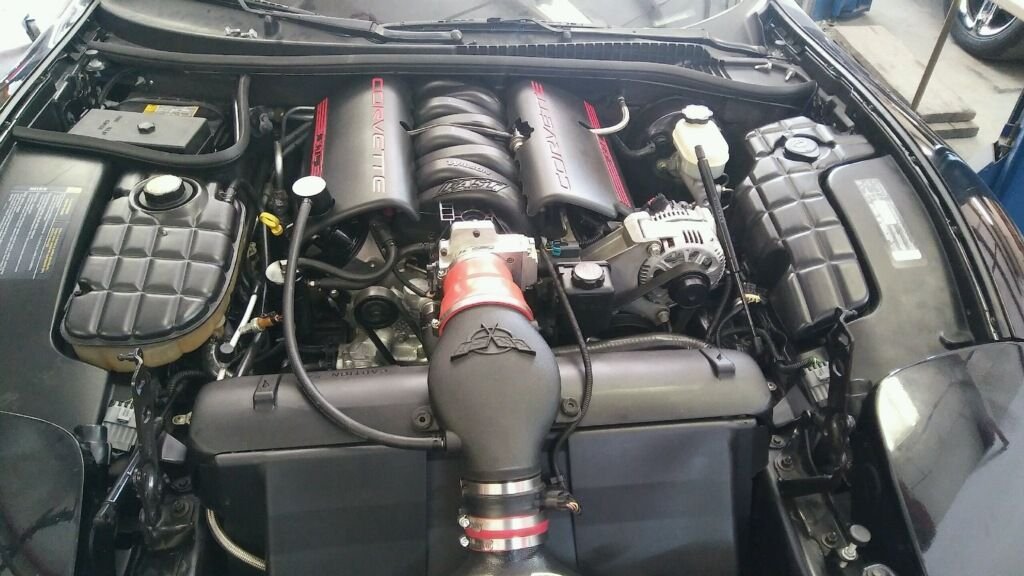

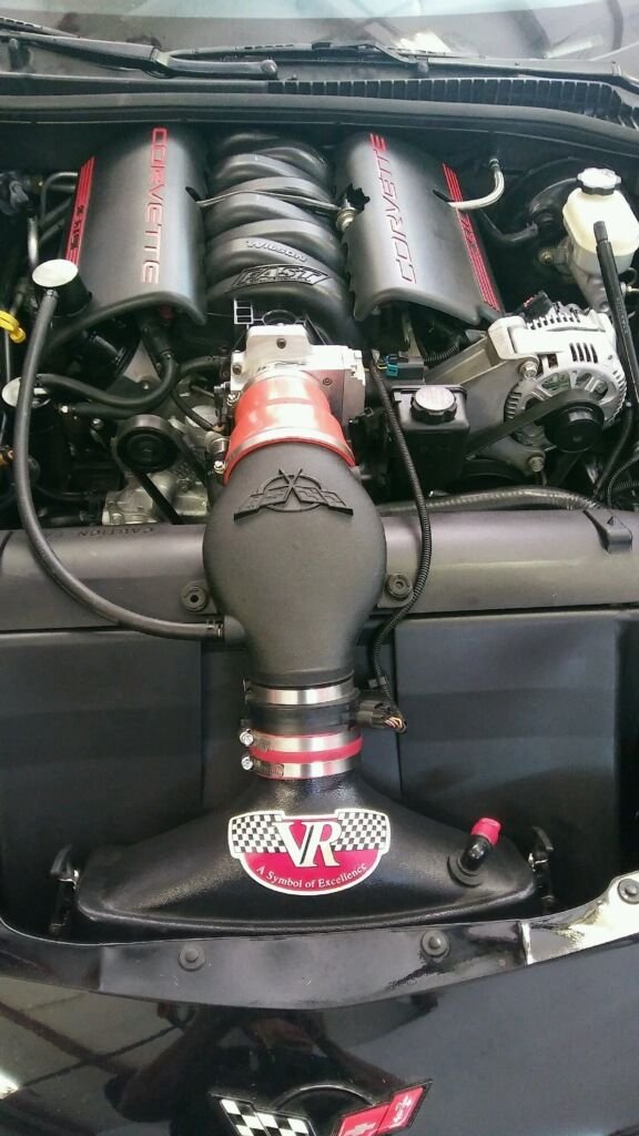

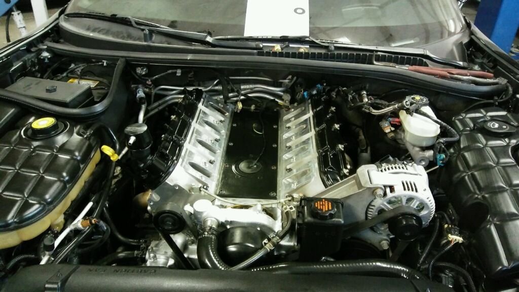

Default Installation complete
Completed engine shows vararam.
Here you cans see the catch can. This one is Elite Engineering but therenare others out there.
