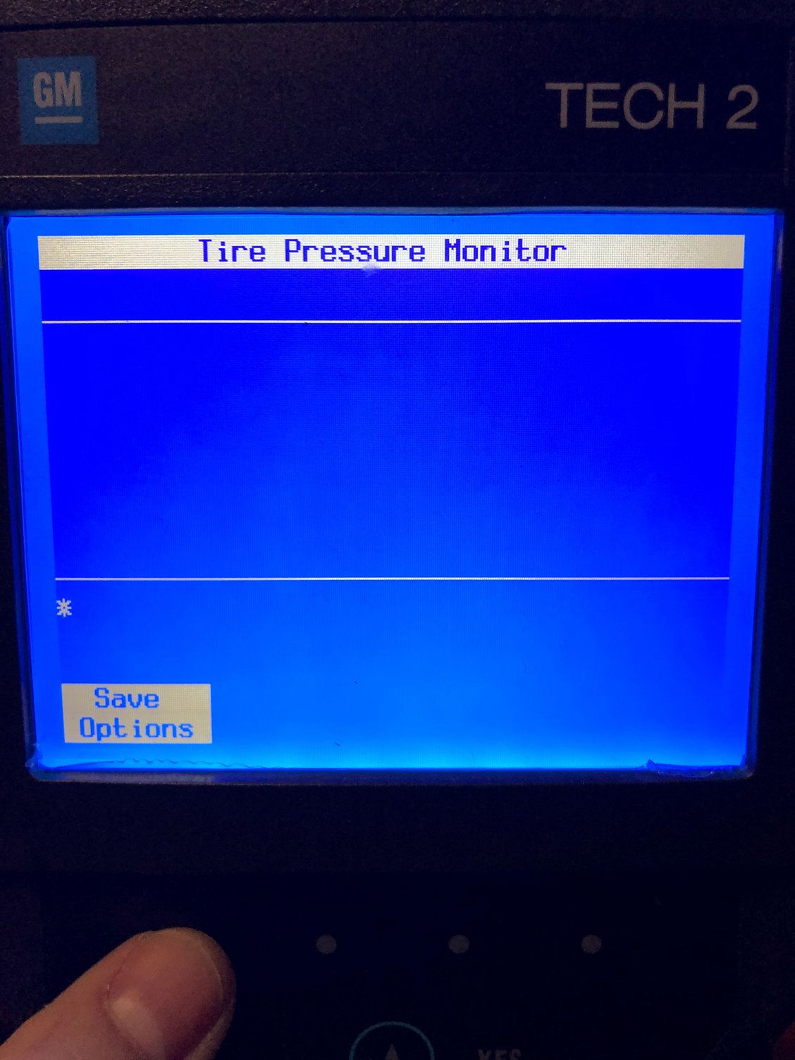

Hi all,
A friend of mine gave me his Tech2 so I can disable my TPMS. When I get to the option the screen where it tells me the status of TPMS is blank and it won’t let me change it. I have the ignition on as it stated but the car is not on. Do I have to have the car running?
i don’t want to screw anything up. 2001 Auto. Thank you all.

pretty sure you can't turn it off

If you're at: Body > Remote Function Actuation > Special Functions > TPMS, then that's the right screen. The option is there on my '01. I wonder why yours isn't showing up.
(Protip for curious people: don't toggle it off if you really don't want to, because then you'll need to resync your TPMS sensors. Ask me how I know that now.)

That is exactly where I am. He didn’t give me the CANDi module because he said I don’t need it for the 2001 but maybe that is the reason. I don’t think it playing nice with the BCM.

I agree we were both trying for a while and still got the blank screen. The car has been in storage on a tender and hasn’t been started in 3mos. I ll wait until I get it out running and try again. Maybe the BCM needs to wake up🤷*♂️

Update. We swapped the software card with another one in the Tech2 and it worked. It was a corrupt software card. I can confirm you can turn TPMS on or off on an 01 and up. Thank you all for the input.

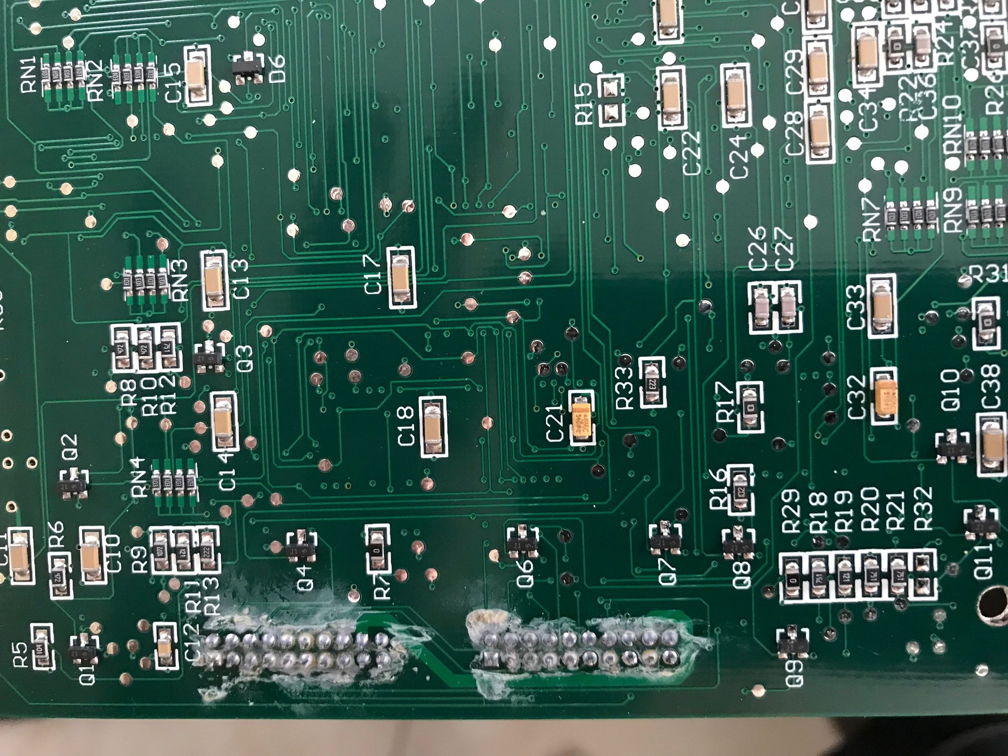

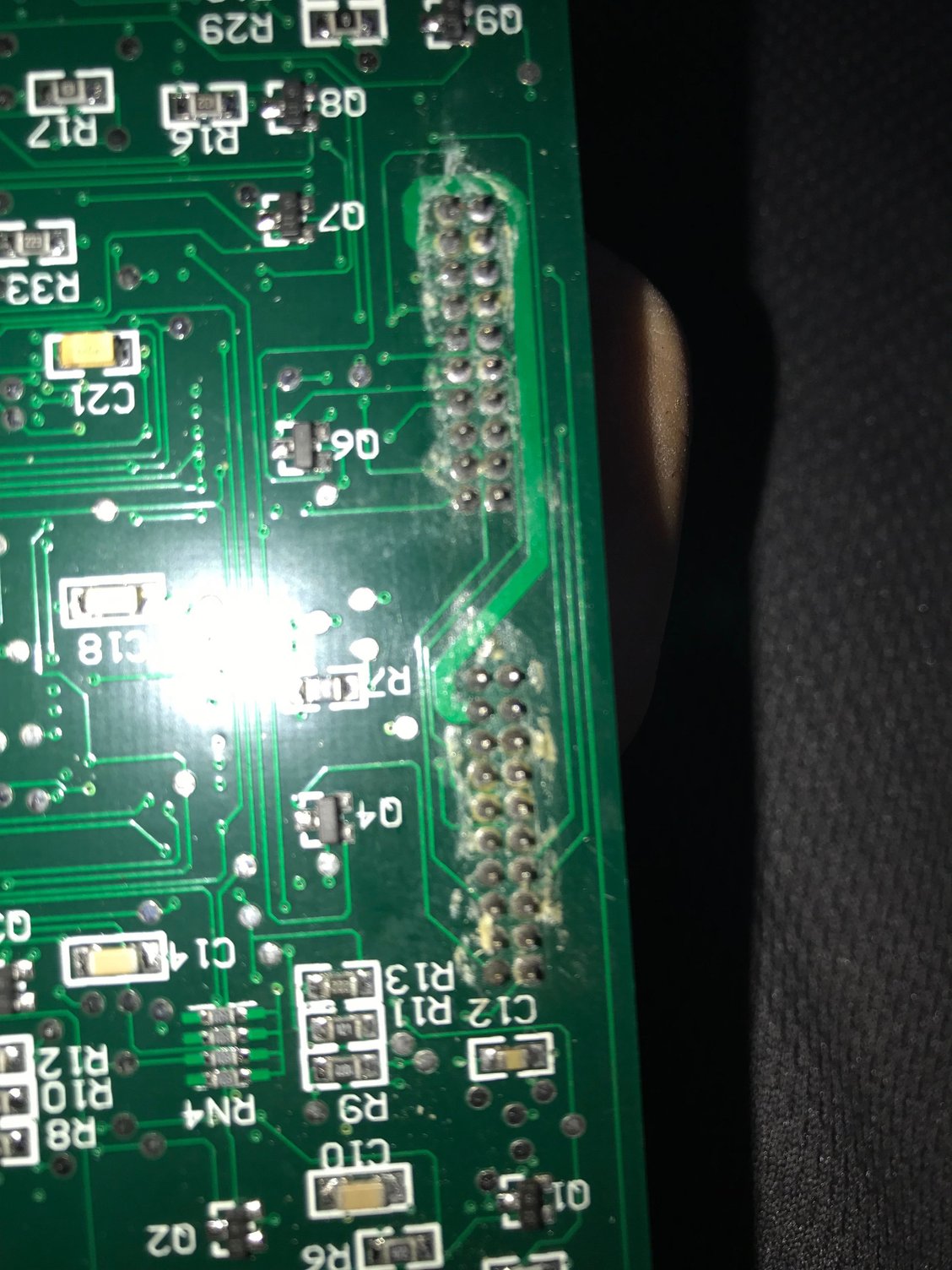

Default Reset TPMS with Tech2 then malfunction
Today I was getting ready to use my Tech2 Clone and kept getting No CANDi connection, took off CANDi and opened it and SURPRISE here is what I got. The Tech2 its like 1 1/2 years old and haven't use it yet besides doing all checks when I got it when new. Bottom picture was when I opened the CANDi and the top one after I tried to clean it up. Seems like corrosion.

That could be corrosion, though considering the garbage quality of these knockoff parts, it may just be a manufacturing issue. Like, say, a bunch of crusty dried flux.
PS, did you use flux when re-flowing the solder?
Do yourself a favor and clean up the areas you reflowed with alcohol ... it'll make it obvious in the future if it corrodes or otherwise looks different than it is supposed to.
