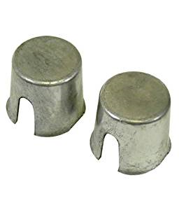

If your battery cables are too loose to secure to the posts just get these caps if that's what you're trying to accomplish !!...they're cheap !!
That's not a bad idea. I may try that.

From Amazon !!
https://www.amazon.com/dp/B0060YI0YS/ref=cm_sw_em_r_mt_dp_U_v2VBCbD0M4C48 https://www.amazon.com/dp/B0060YI0YS/ref=cm_sw_em_r_mt_dp_U_v2VBCbD0M4C48

The post itself is fine, just the clamp on the cable itself is bent and doesnt always have a good connection to the battery terminal. I'm going to run by parts store today to see about picking up some new cables all together, or may looking getting those shims as mentioned above.
