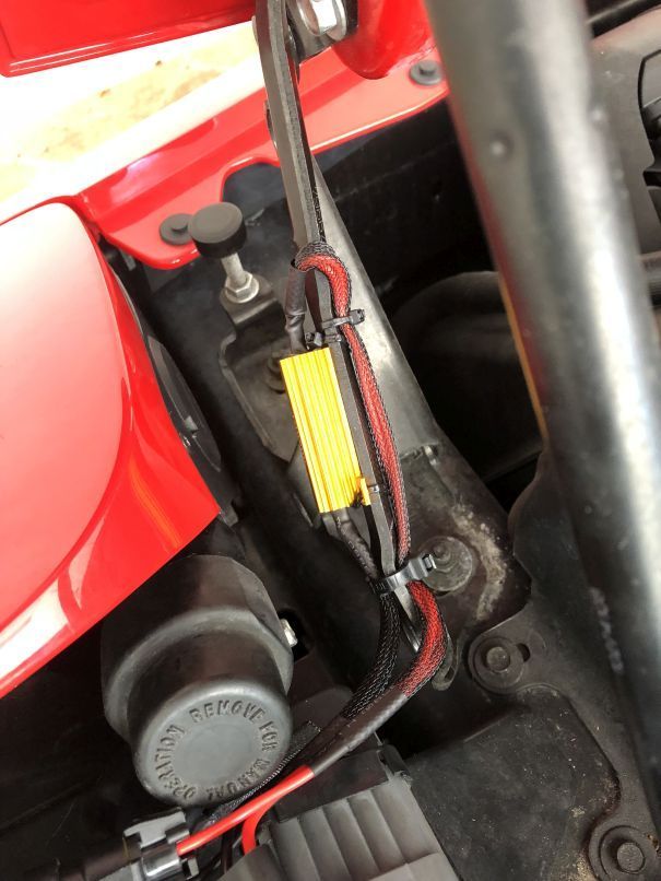

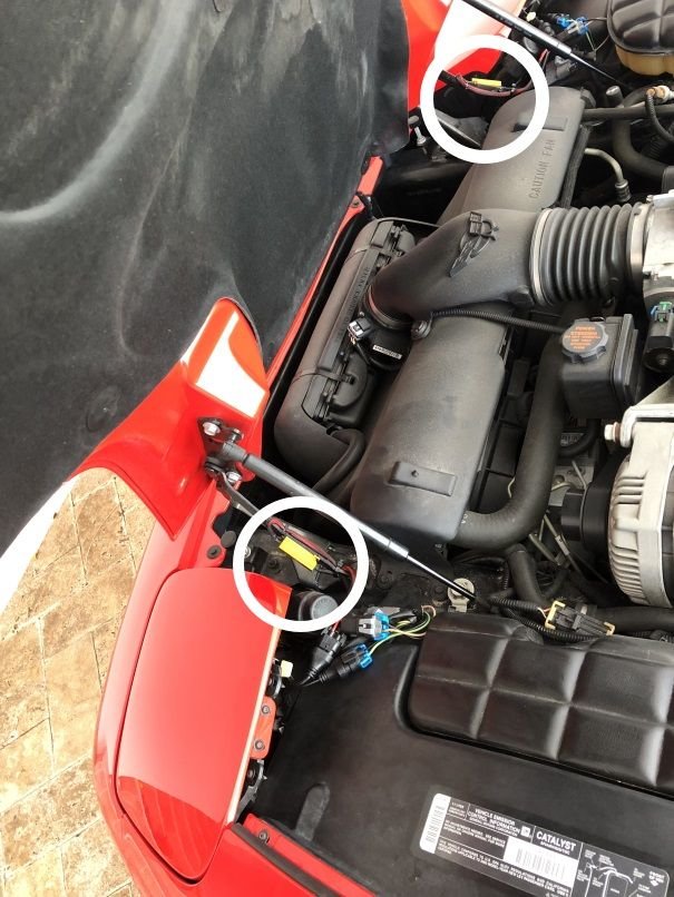

"this thread" is me. A different type of resistors didn't work. I will order the ones Zoidman is using. We'll see.

Default Solved
These work, everybody. Headlight doors now behave normally.
