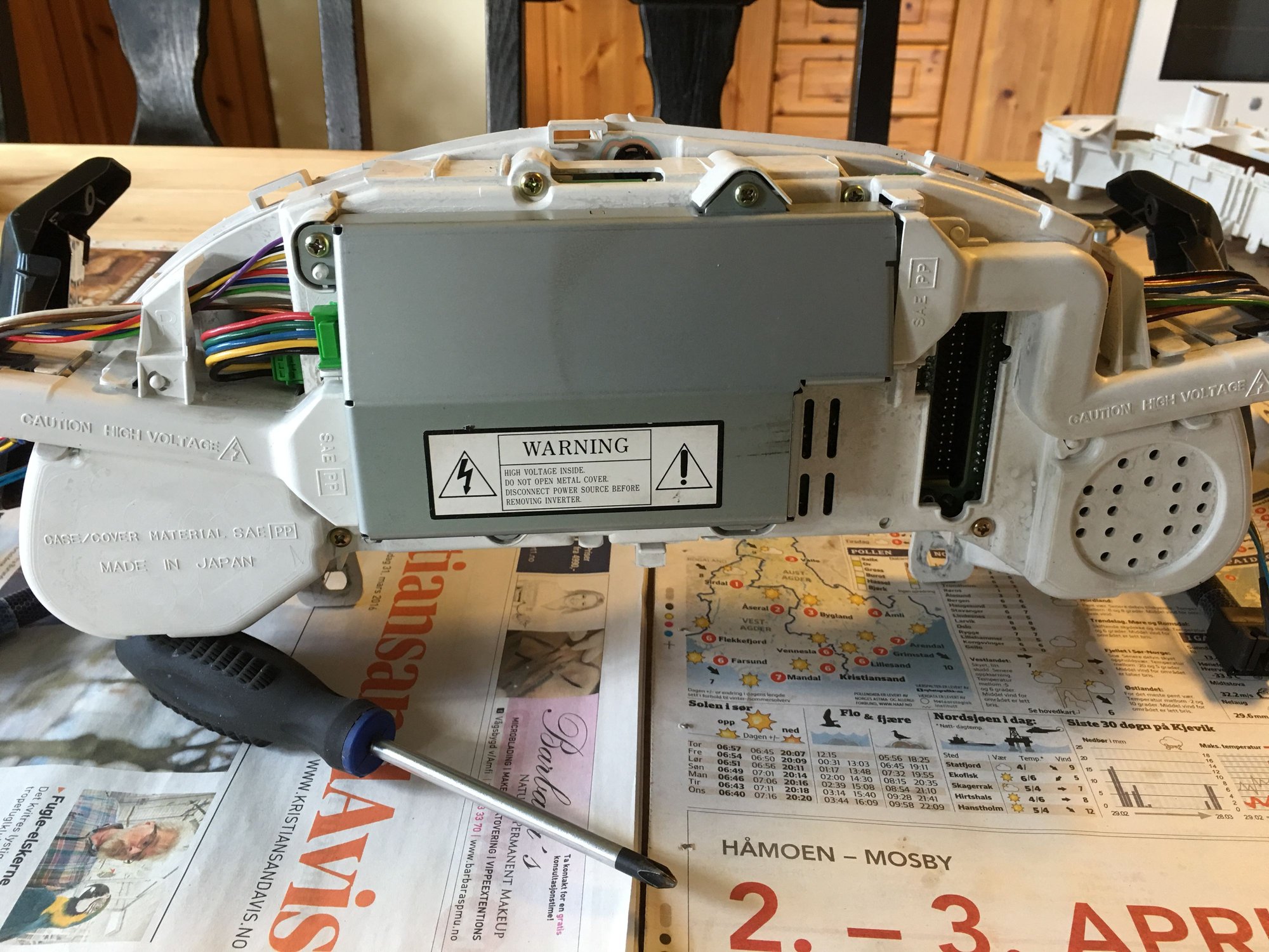

This High Voltage powersupply is feeding two high voltage fluorescent UV tubes that get the gauges to glow
​​​​​​​Check this one out , it may be your case https://www.corvetteforum.com/forums...on-t-work.html
