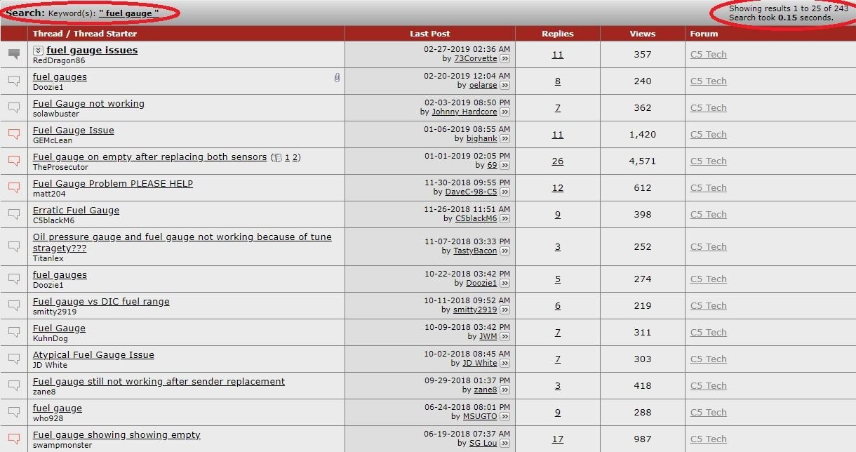

Originally Posted by Kim Hil
Is this something common with the C5?
You betcha. I think the fuel gauge issue and the "column lock" issue are the most discussed and repeated. You will find your answers in the Tech section. But, yes, buy a bottle of Techron and add it to your tank before filling up. Your gauge will start working properly after a while.
