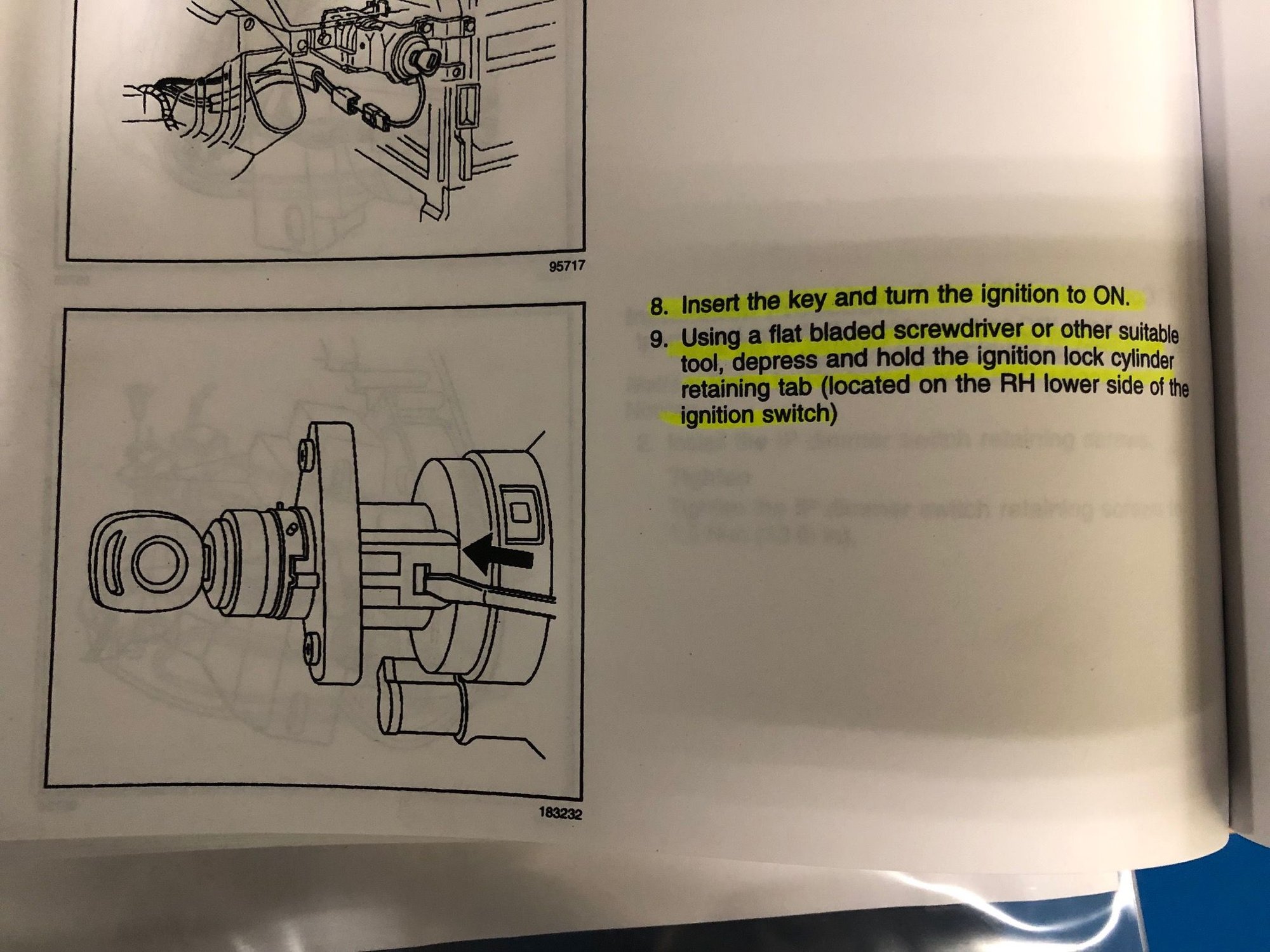

Yes, understood. I feel pretty confident to do the all the process, but do you by any chance maybe have a picture of what terminals to verify on the switch afterwards? Just a visual to insure I test across the switch on the right places? The testing doesn't bother me, just not as confident I know specifically which terminals to test.
*EDIT* Never mind Bill, I found your hand drawn schematic in the repair thread.
Having said that...is it possible to change the key cylinder from the old switch to the new? If so, is there a trick to removing the cylinder? A new switch is +/- $70 and I'm not opposed to just putting in a new one (I'm second owner of car and in the process of getting everything where I know it should be, kind of baselining the major components), but would prefer to not have to re-key if I can get away with it.

First off I would list the details of your C5 in your profile...year, trans, mods,etc !!...sometimes there ARE variances in wiring from one model year to the next. You change out the old cylinder to the new...plug and play !!...this is out of my 01's FSM.

Wiring from my '01 FSM...if you need guidance on the switch R&R let us know !!!
