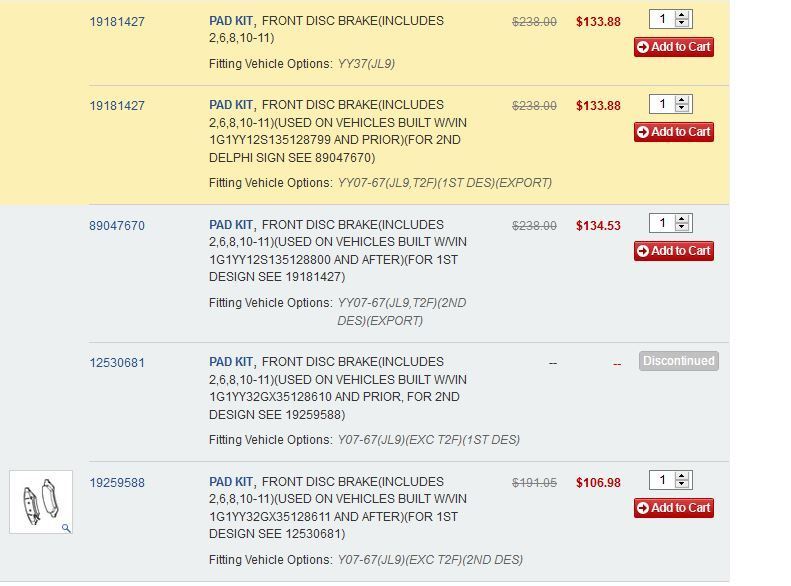

I was searching online at a GM parts supplier in Michigan that I had used before and found the rotors for my car without a problem but the pads were not listed. So I used the chat box to talk with a rep from the company. I asked him why the pads weren't listed and that's when he said that a change occurred after vin number 35128924 and he referred to them as "Version One" and "Version Two". He could not guarantee that the pads he found would fit my car. That's when I consulted the forum. Still can't locate front pads at GMPartsNow or GMPartsDirect.

The terminology is wrong for version 1 or 2, should be 1st design or 2nd design.
Found part listing here: https://www.gmpartsgiant.com/parts-l...mbers=19181427

Yes, you're correct. Got it wrong. Odd that I could not find the pads on either GMparts Direct or GMPArtsNow. They seem to use the same parts diagrams but different prices.

The 1st des vs 2nd des is not about fitment but rather the compound. i.e. semi-metallic or ceramic.
