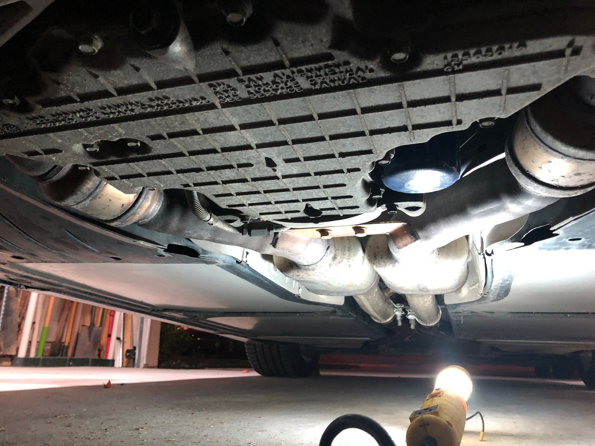

The system is LT’s and cats. The cats would bolt “clamp” to the section of pipe with the rear o2 sensors then into the Corsa x-pipe. So d have to cut that section off just behind the factory cats in order to use it.
Which is no big deal. See photo. I’m liking what you are saying though. It isn’t a daily driver and I have a garage. So I can walk away from it for a while if the frustration level gets to high. Lol
