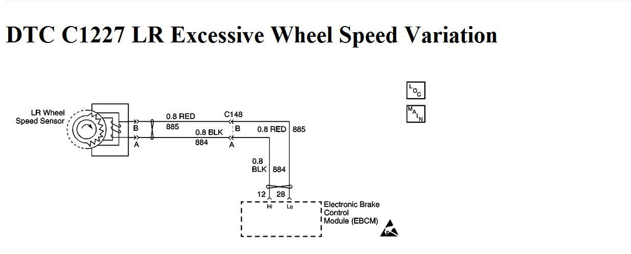

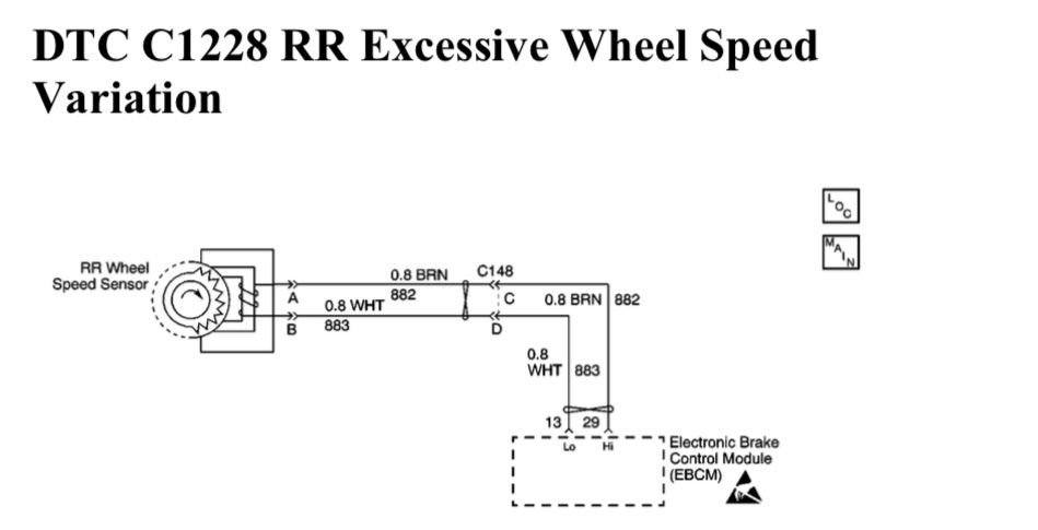

You did not write what year your car is , but this shows the 2000 wiring for the Right Rear wheelspeed sensor
Check the connectionpoints/plug for bad connection
Measure the resistance between terminals A and B of the WSS , should be 850- 1350 ohms
With DMM still connected, select the mV AC scale and Spin the wheel as fast as you can by hand while monitoring the AC output , should be above 100 mV
This will check the wheel speed sensor if it is working correct or not

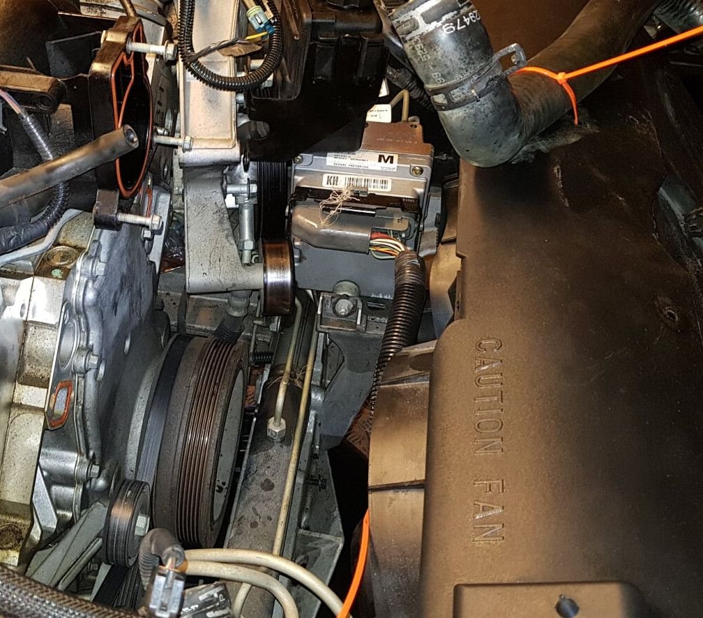

And I have Another problem , the battery is draining out.I have a optima red top battery. I gonna check the all grounds. For the 2000year model I've heard that the ebcm module is at the rear but I can not find it. Isnt it at the front?

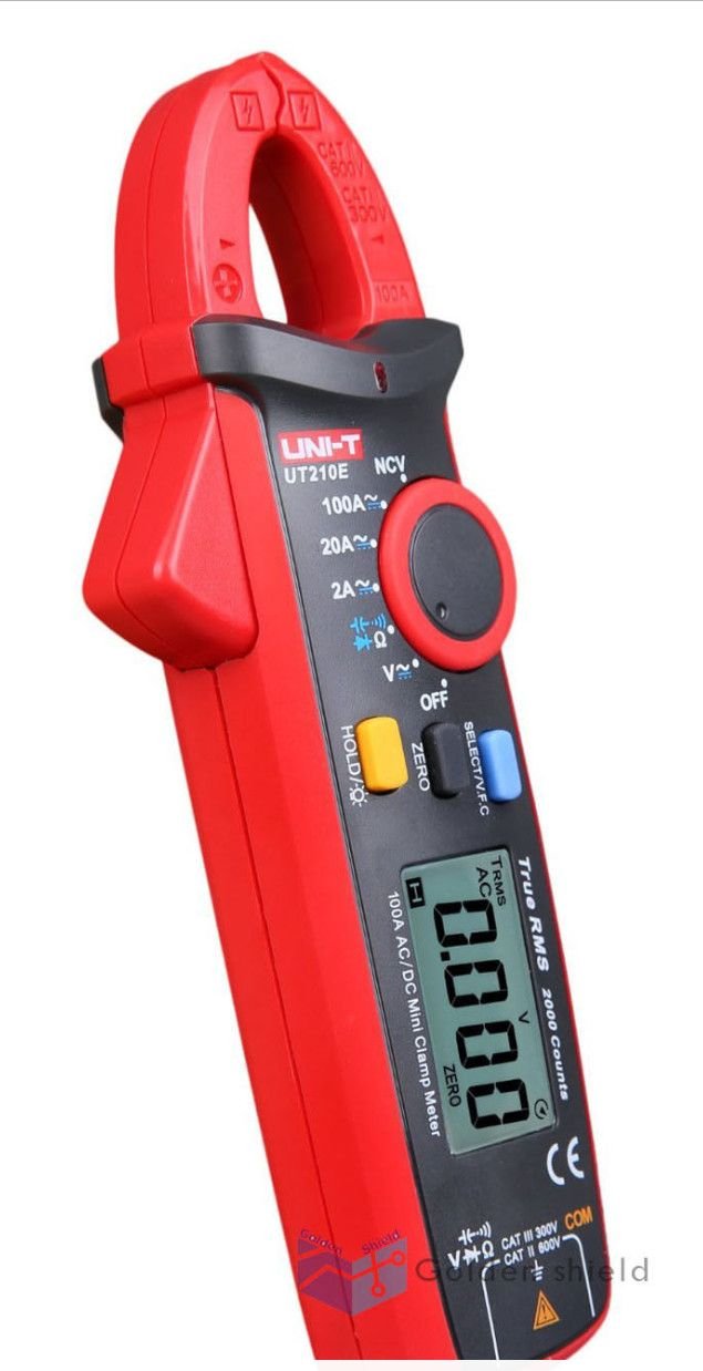

I prefer to use my cheap ( USD 36 on ebay) but accurate enough amp clamp meter when doing current measurements . Then I do not have to open the currentloops to measure the current
https://www.eevblog.com/forum/testge...-uni-t-ut210e/

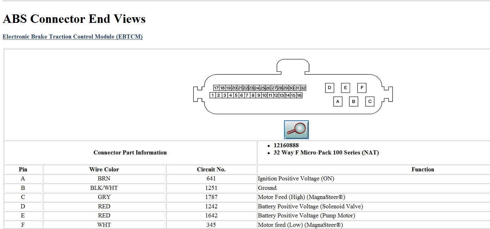

Regarding DTC 1227 and 1228 then I would on my car , disconnected the battery first and then the connector on the ABS unit .
Measured the AC voltage generated from each at each pair of wheelspeed sensor pins on ABS plug when rotating the wheels when the car on jackstands .
Then I would be able to verify if the voltage from each wheelspeed sensor is getting to the ABS unit

If you see on this EBCTM drawing the stoplamp switch close when you apply brakes and battery voltage is applied from Maxifuse 8 to brakelights and the EBCTM input terminal 9 .
Maybe the electronic logic disable the speedsignal alarms during brake operations . I do not know
