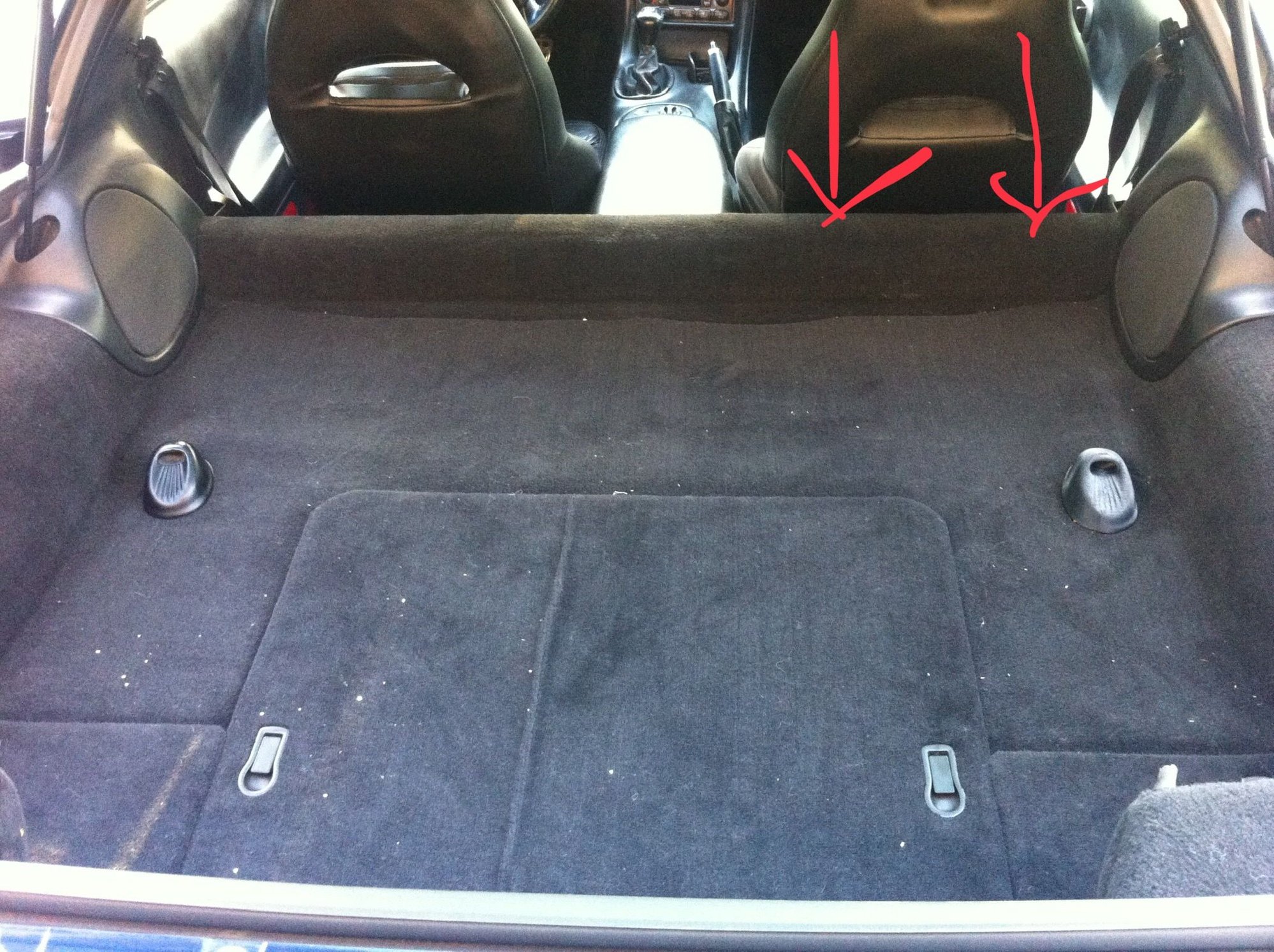

Nervous about this one...
I know the gas tanks are right behind the seats, but I believed I had clearance towards the top.
I drilled behind the passenger seat downward in the location of the red arrows.
I had the drill bit stop collar set so that I barely pierced the metal. Both hole seemed to drill fine. And rivets went in freely.
But upon using the dust buster to clean metal shavings, I smelt the faint smell of gas being shot out of the dust buster.
it was the hole towards outside of the car (basically the furtherest hole from the gas tank vent). And I really had to put my nose directly to the hole to smell anything. But there was the faint smell of gas from only the one hole. Could this faint smell possibly be normal? Or should I drop the passenger tank and check for any damage or leaks?
When I put the interior back together I smelt absolutely nothing. But obviously that could change when I start the car. I currently only have 1/4 tank so maybe that’s why the smell is so faint?
Anyway here is where I drilled

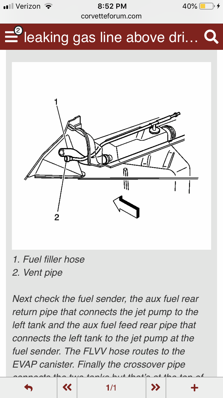

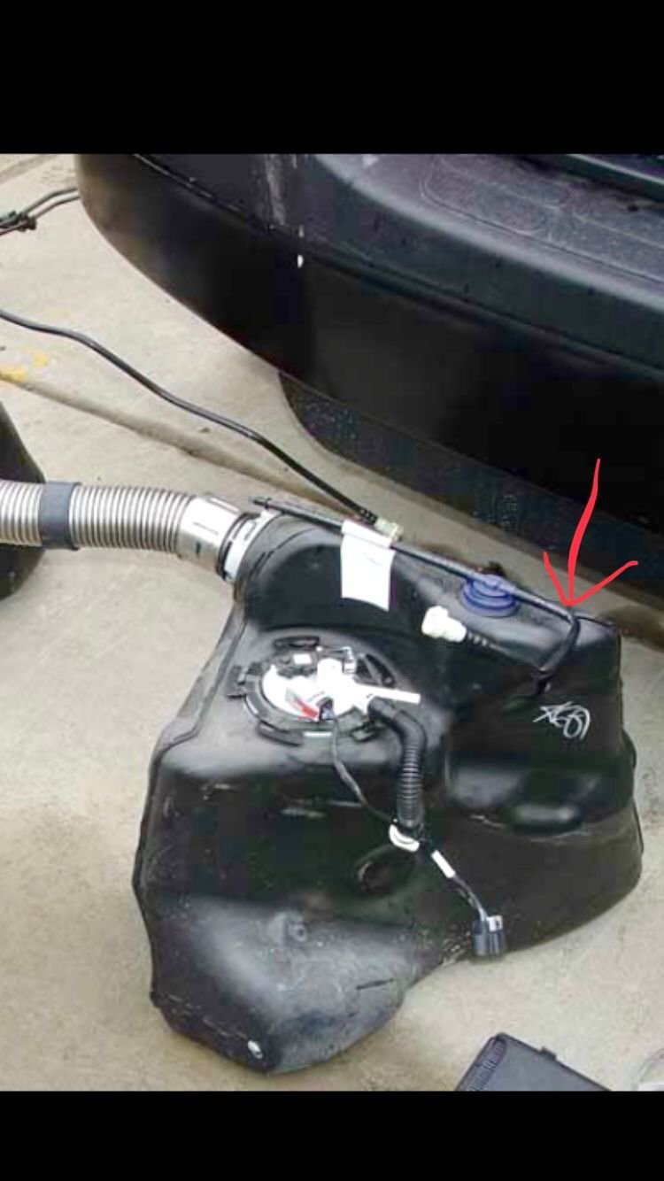

The spot I drilled is right above the gas vent pipe. Is it possible I smelt the vent pipe? Assuming it vents to atmosphere? There is no more smell of gas. I’ve primed the fuel system several times with the key and no leaks or smell. but I’m not sure if this would tell me anything because the car wasn’t running.

No remotely modern vehicle vents fuel vapor to air, it's always collected and eventually burned via the vapor canister. If, and it's a big if, you pierced the vent line you will know it pretty fast by a CEL, probably the same CEL a loose or worn fuel cap develops. I would think that when it doesn't develop a sudden increase in fuel vapor CELs you'll know you didn't pierce the vent line. I say a sudden increase, since I know I haven't hurt mine, and I get the occasional CEL for fuel vapors, and so do others I'm familiar with. I clear it, and it goes away for a considerable length of time.

you are correct I believe it vents to a charcoal filter. I will start the car and check for CEL / codes

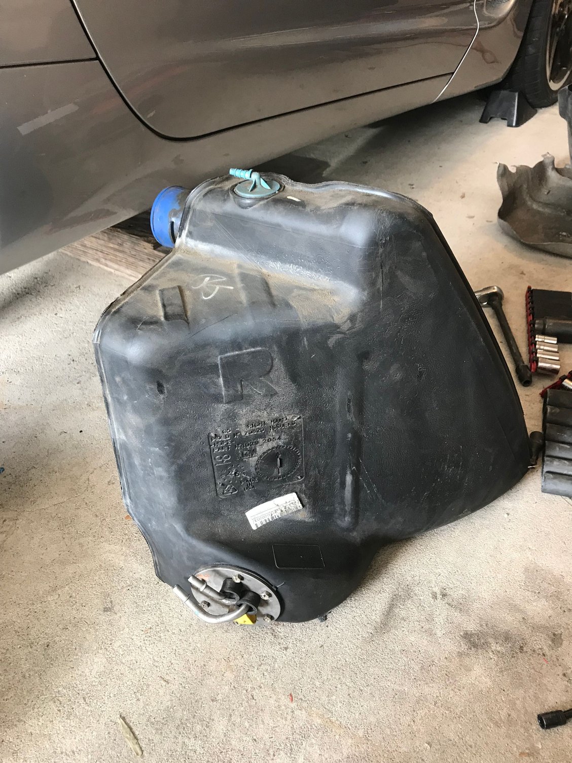

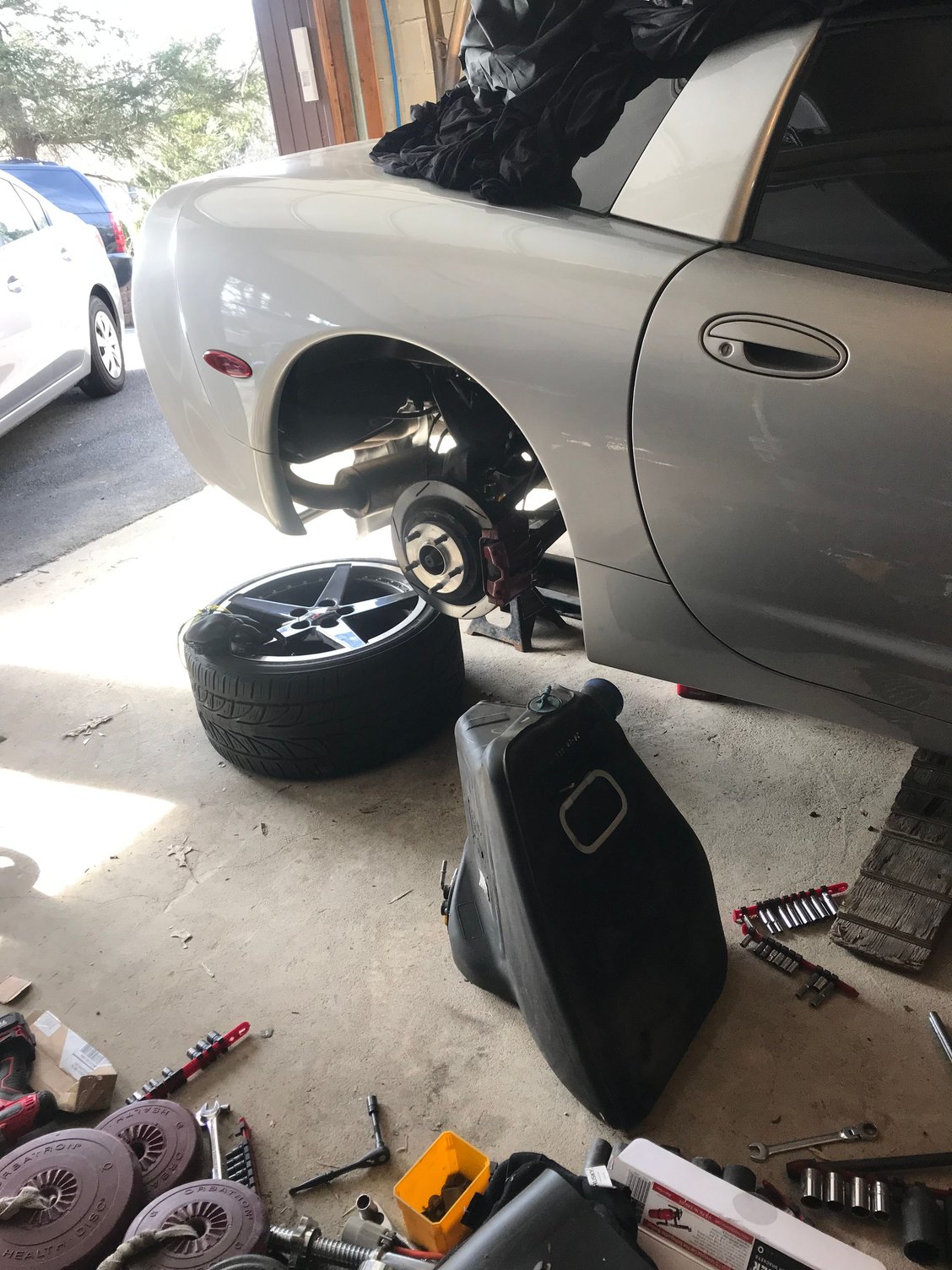

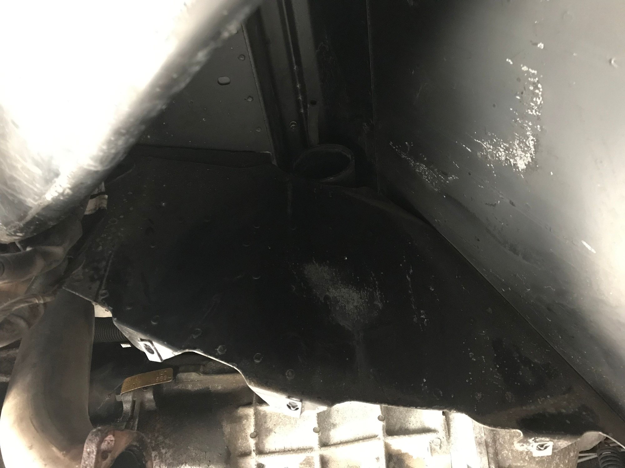

Turns out I didn’t hit the tank. Dropped the passenger tank and could see the scratch marks where I probed with a dental pick. No holes and tank is fine.
One thing I don’t understand is that I reviewed maybe 6 different diagrams for different evap systems, cross over tubes, etc for the C5. And mine wasn’t similar to any of them.

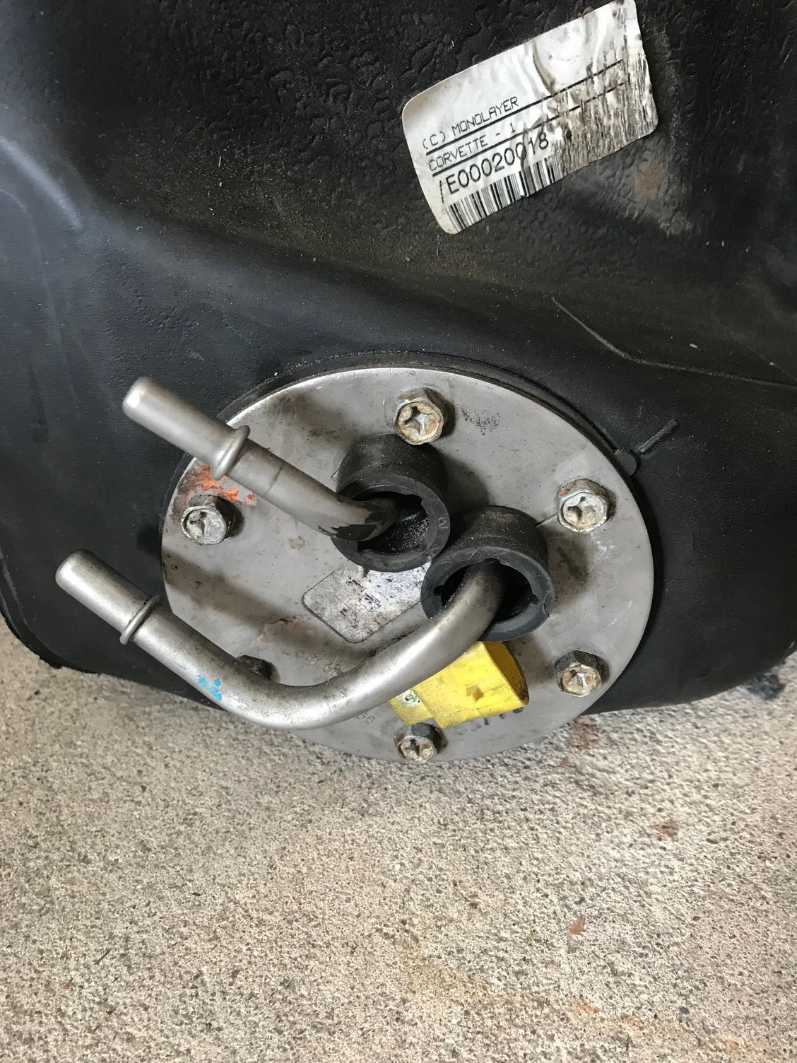

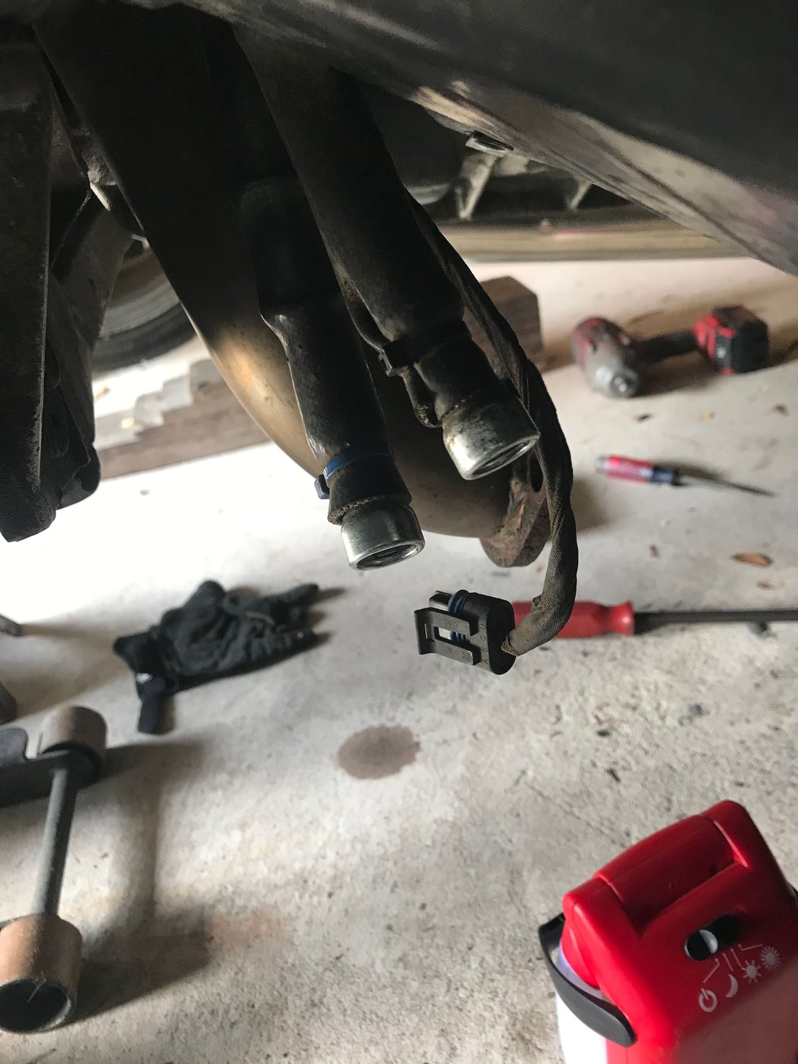

Mine was literally just two fuel lines and a sensor coming off the pump, the cross over tube, and above the cross over tube was just a soft vent hose that went back towards the drivers side tank. And that’s it for the tank to completely come down. All the diagrams I saw were way more complicated than that.
