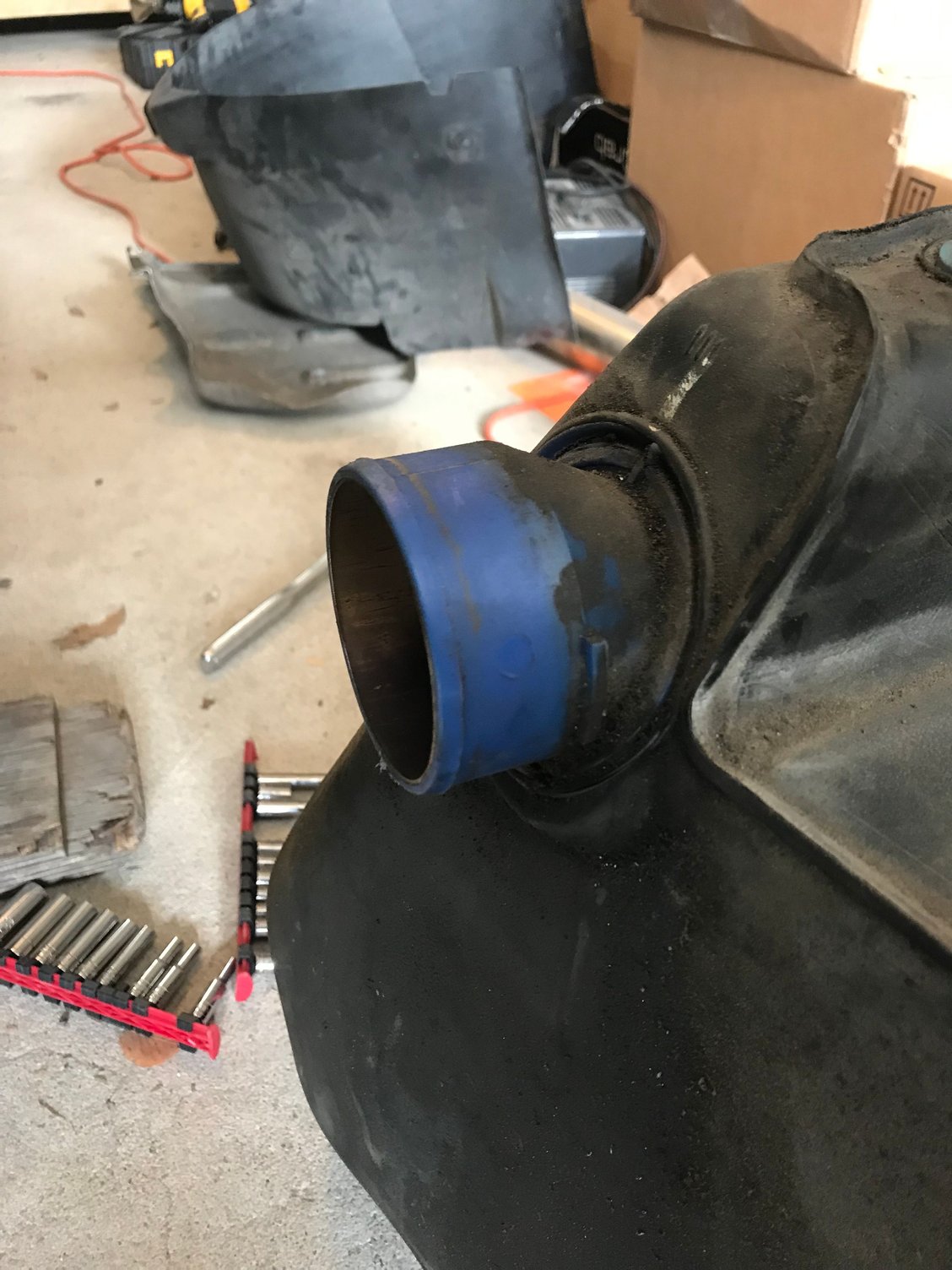

1998 with the rubber cross-over pipe.
Is there any way to lower the passenger side tank enough to get a look at the evap canister / lines?

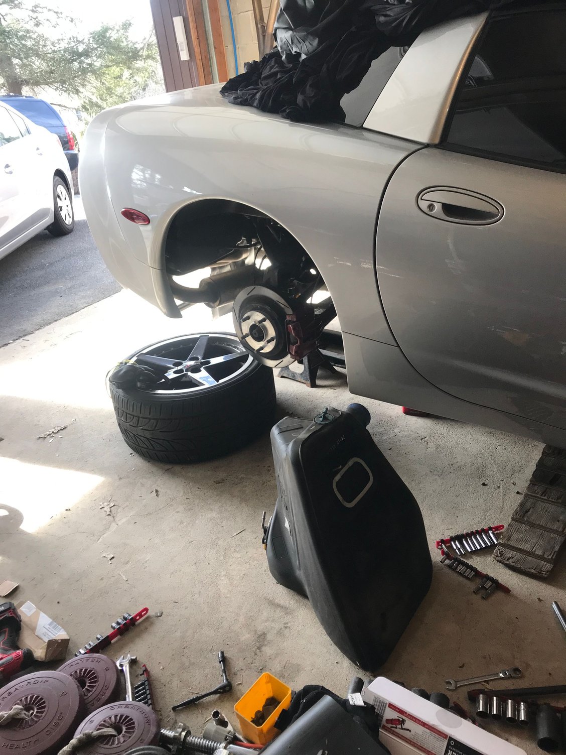

I have the wheels off, fender liner off, tank shield/strap down, exhaust down. I would think the tank should able to move a little at this point. I can feel some play in the cross over tube and lines coming from the pump so I would expect the tank to at least wiggle back and forth. But the tank feels solidly mounted like there is still one last bolt that I can’t seem to find.
Is there a hidden fastener? Or some type
of adhesive that I am missing here?
Thanks all!

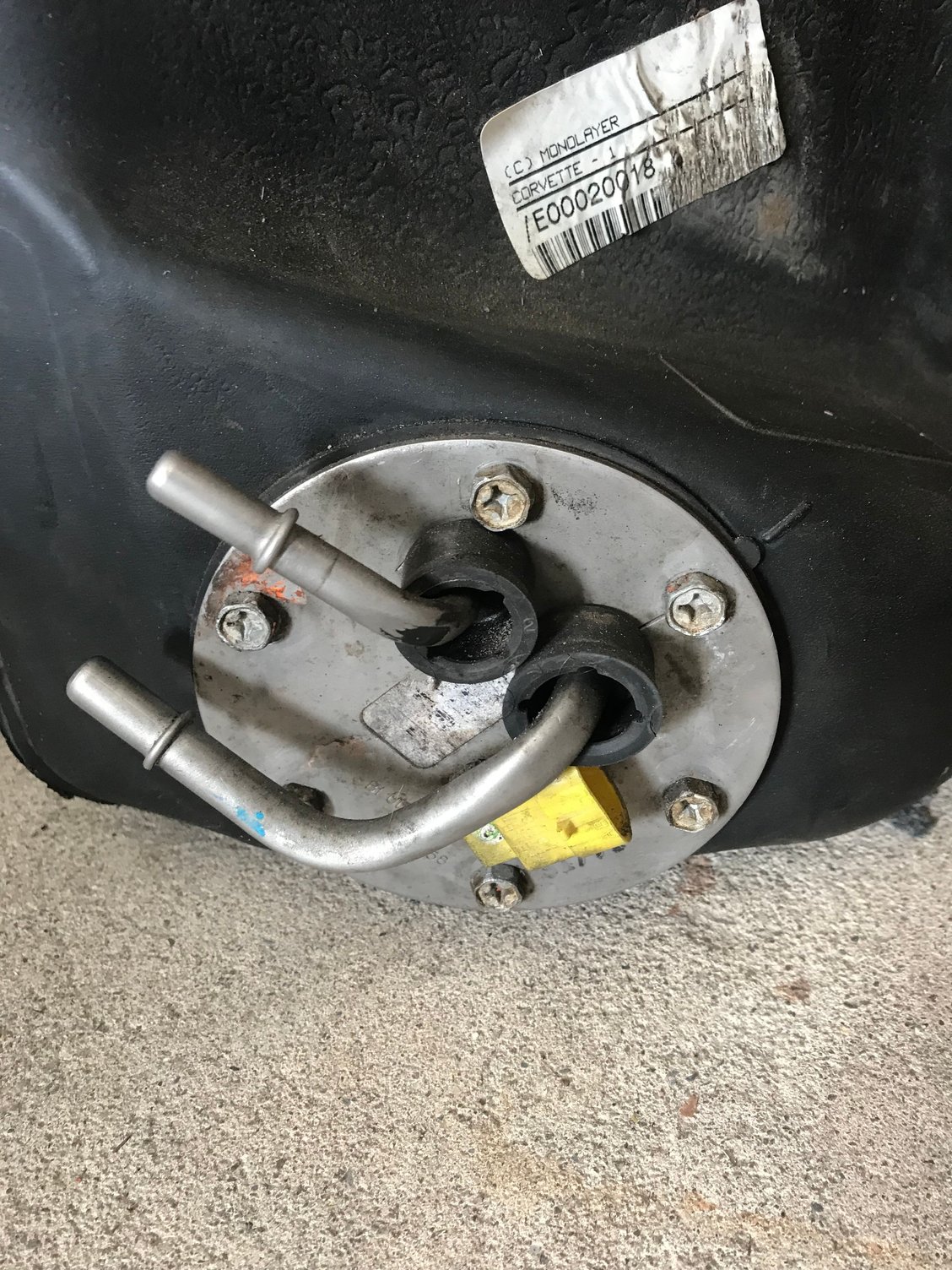

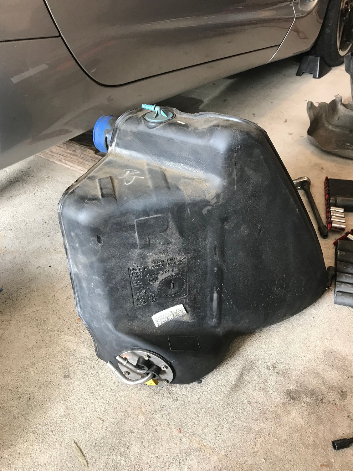

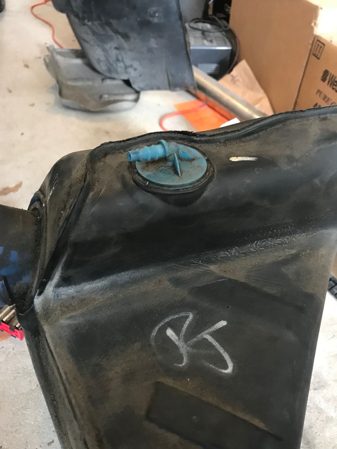

Just to follow up, my tank had some kind of epoxy or adhesive not letting it drop. Once that broke free, to drop the tank it was literally just 2 fuel lines and a sensor from the pump. The cross over tube. And a vent hose. All the diagrams I saw were way more complicated than mine seems to be.
