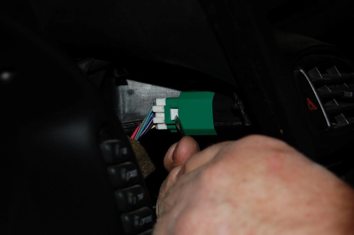

Not sure where in the video he is disconnecting the harness, I do mine at the switch as pictured in the 1st photo which is from a web page, your gauge assembly has to be removed to do this, the other 2 photos show the back side of the switch where the harness plugs in.
If you PM mstromquist here on the forum he can give you the info you need as I would imagine you were watching his video.

If your CE is the same as my CE (I don't see why it wouldn't be), there are 2 places you can unplug it. There is a connector you can get from underneath the lower dash or kneepad, or you can do it like 6speedsteve, at the back of the switch. I have done it both ways, and prefer disconnecting at the switch. 1 less wire / harness to fish while putting it back together. Once you get the dash loose, slide it towards the back, reach behind it and disconnect. A small screwdriver helps when depressing the locking tab.

Looks like he disconnects it where it plugs in to the harness on the right side of the steering column, when he removes the dash you can see the harness from the switch hanging from the dash. I think the bolster he talks about is the one below the steering column. I could not find any pictures I have that show where it goes near the column.
