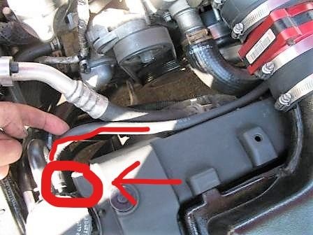

i have the throttle body bypass already done but now I am changing all my hoses.I prefer buying my hoses by the foot but don't know the sizes of the hoses. Anyone have any idea what size goes from the radiator to the coolant pipe on the engine? This is for my 2001
Thank you!
Found these pics from the web while trying to research but could not find anything.

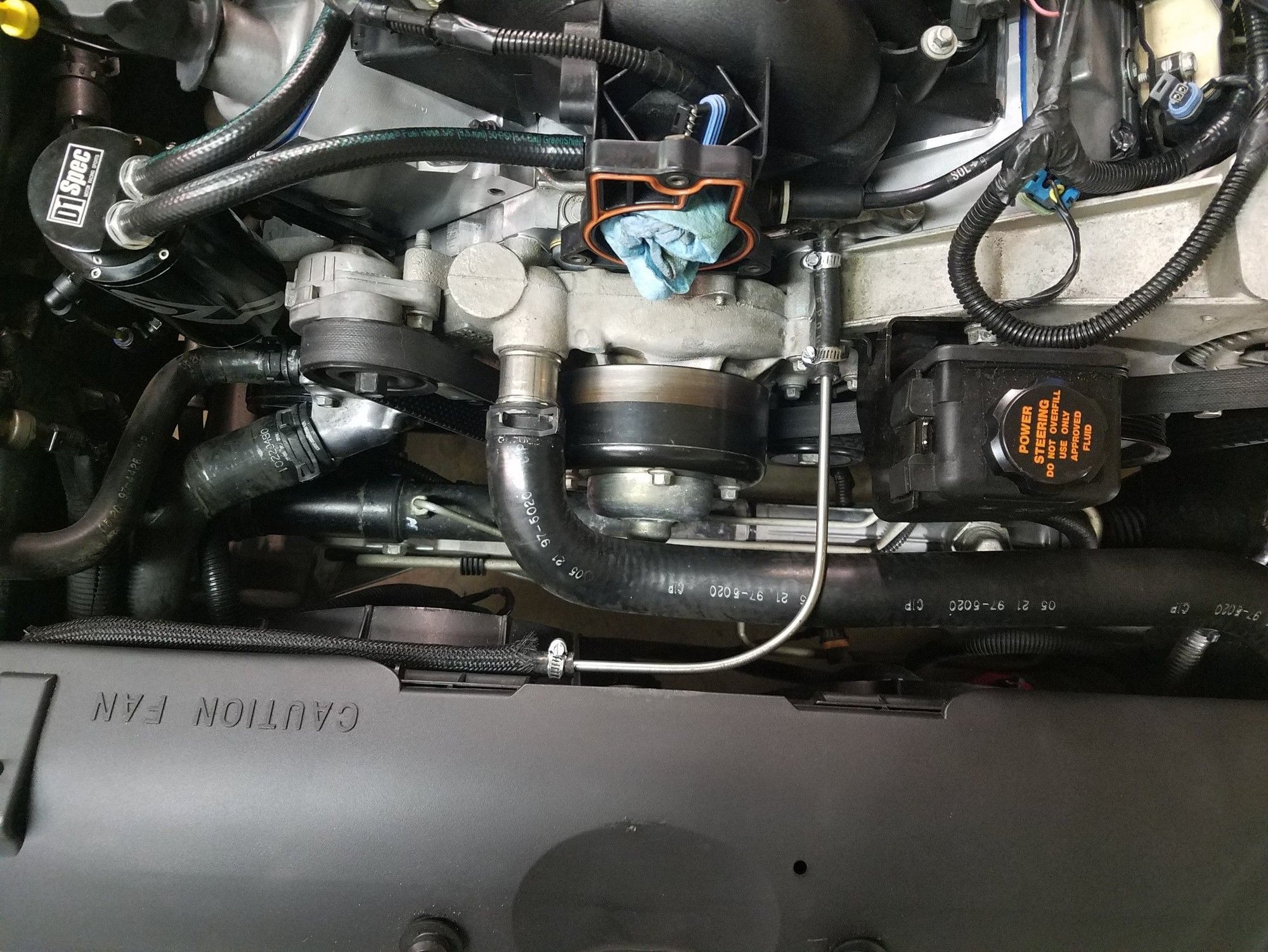

I did this last year, I read the forum and someone listed a wrong size, it was too small of ID and if I would try to force it on the radiator side, I feared of breaking the nipple so I went out to get the correct size. I want to say 3/8 inch but would need to confirm it for you. I covered it with black braided nylon so it might be hard to get a reading off the hose.
1/4 inch is definitely too small

Nice setup.
