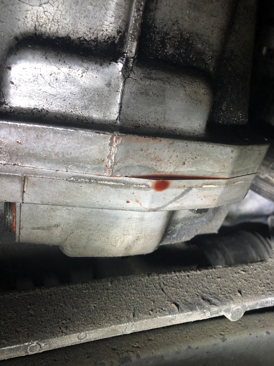

Another common place for a manual trans leak is between the extension housing and the main transmission housing. There's no gasket. Instead, GM used an anaerobic sealant to mate the two surfaces. This sealant breaks down over the years and causes a leak. You will see transmission fluid accumulating around this area when under the car. I took this pic before pulling the drivetrain, replacing the clutch and resealing these surfaces.

Originally Posted by FR-CYA
As was mentioned by wscott62893, manual or auto?
i believe that’s the exact location of the leak!
