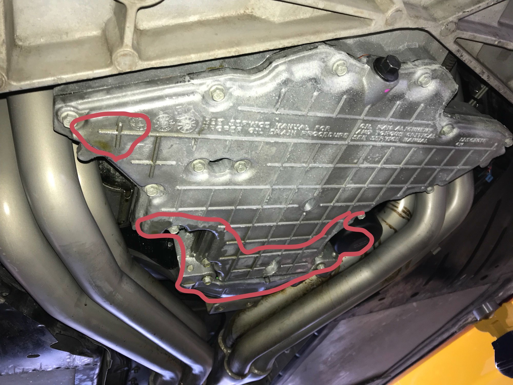

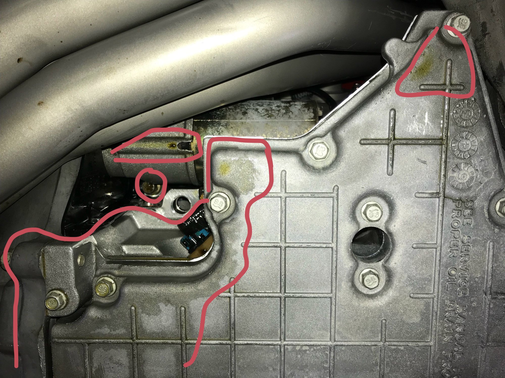

I’ve got a new engine and I’m fairly sure it’s coming from the main seal but before I pull it apart I thought I’d ask around. I’ve included a couple pics, you will find oil on the rear starter bolt and one or two higher bolt heads on the apposing side as well. I see nothing combing down either side of the block. The majority looks to be on the passenger side having a little more collected from the starter down, it seems that it’s happening mostly when your really gretting on it hard. I thought it a little strange that the oil would travel forward as it did.
Thanks Rich

Oil leaks are always tough to tell the origin. But I just recently had to replace upper and lower oil pan gaskets and rear main seal.

Maybe the oil dip tube o-ring is damage or mis align.

Check your PCV tube that runs behind the intake for a hole.
100% They crack/split all the time!
