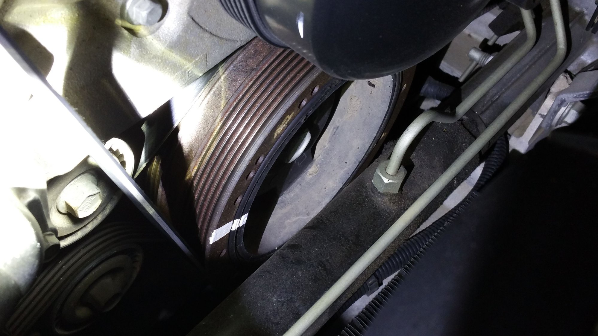

Originally Posted by Grandpa1
Put a white indicator mark inside to outside and check it every now and then to see if the HB has moved. Check it once a week or so.
If the mark does not stay in line you probably need to replace the HB.
I had it replaced on my 03 vert. Cost me around $500 parts and labor. I used the Powerbond HB with the ARP bolt.
I also changed out tensioners, idlers and belts. That cost extra.
Good luck!
The balancer in my '99 came apart (luckily) just a few hundred feet out of my driveway, it hadn't shown any of the tell tail signs of impending failure beforehand. I swapped it out with a Powerbond myself.
I've put a paint mark on my Z06's and keep an eye on it. Hopefully when it comes time it'll give me a little warning.

It's possible the wobble is just a visual effect of discoloration. Looking at mine, you'd swear it wobbles, but I can touch a stick to it while the motor idles and verify that there's no perceivable in-out movement.

Its not the center hub or bolt that is the issue..Its the sleeve on the rubber isolator that comes off. Through the years, the rubber deteriorates and the sleeve starts moving. How loose you let it get....is up to you. Cant make a horse drink water. Idle or off idle,, it probably wont do much. Throw the belt,,make a lot of racket,, scratch things up pretty good. 6K RPM is a whole different ball game. Could rip out your tensioners,,your Idler pullys..Go into your power steering pump..crack your timing chain cover...etc. and etc. You could get lucky and it will just come off and lay there. The choice is yours. At any rate, its a tow truck ride for your Corvette. In my opinion,,, its a waste of time painting lines on a wobbling balancer. Kinda' like playing Russian Roulette. If its not wobbling,,, dont worry about it. If it wobbles,, then just change the dam thing. If you do your own work,,it dont cost that much. Kinda like....I see that bulge in my tire,,,Ill just wait and see if it gets bigger.. Maybe Ill just paint a white line around it....
