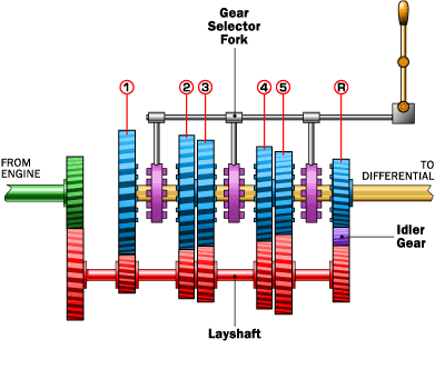

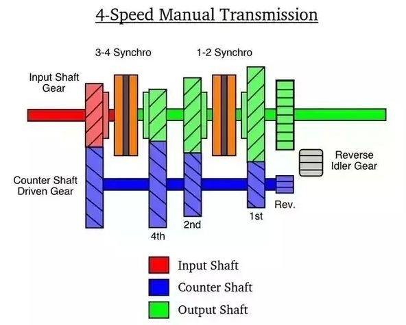

Please correct me if I'm wrong as I've never torn down a T56, but typically if a transmission doesn't have reverse in-line with a foward gear (as per the shift pattern), then it's not engaged via a dog clutch / slider instead engaging and disengaging the reverse idler gear. And it is in fact this design aspect that allows such a transmission to simultaneously engage a foward gear and reverse should a linkage come undone.
It's the difference between this (for example, yes I know that's not a T56) where reverse shares a dog clutch with 5th and the idler is always engaged.
and this where the reverse idler is engaged and disengaged via its own linkage (for example, yes I know that's not a T56)
And in both pictures above, you can think of each dog clutch representing a vertical line in the shift pattern.
