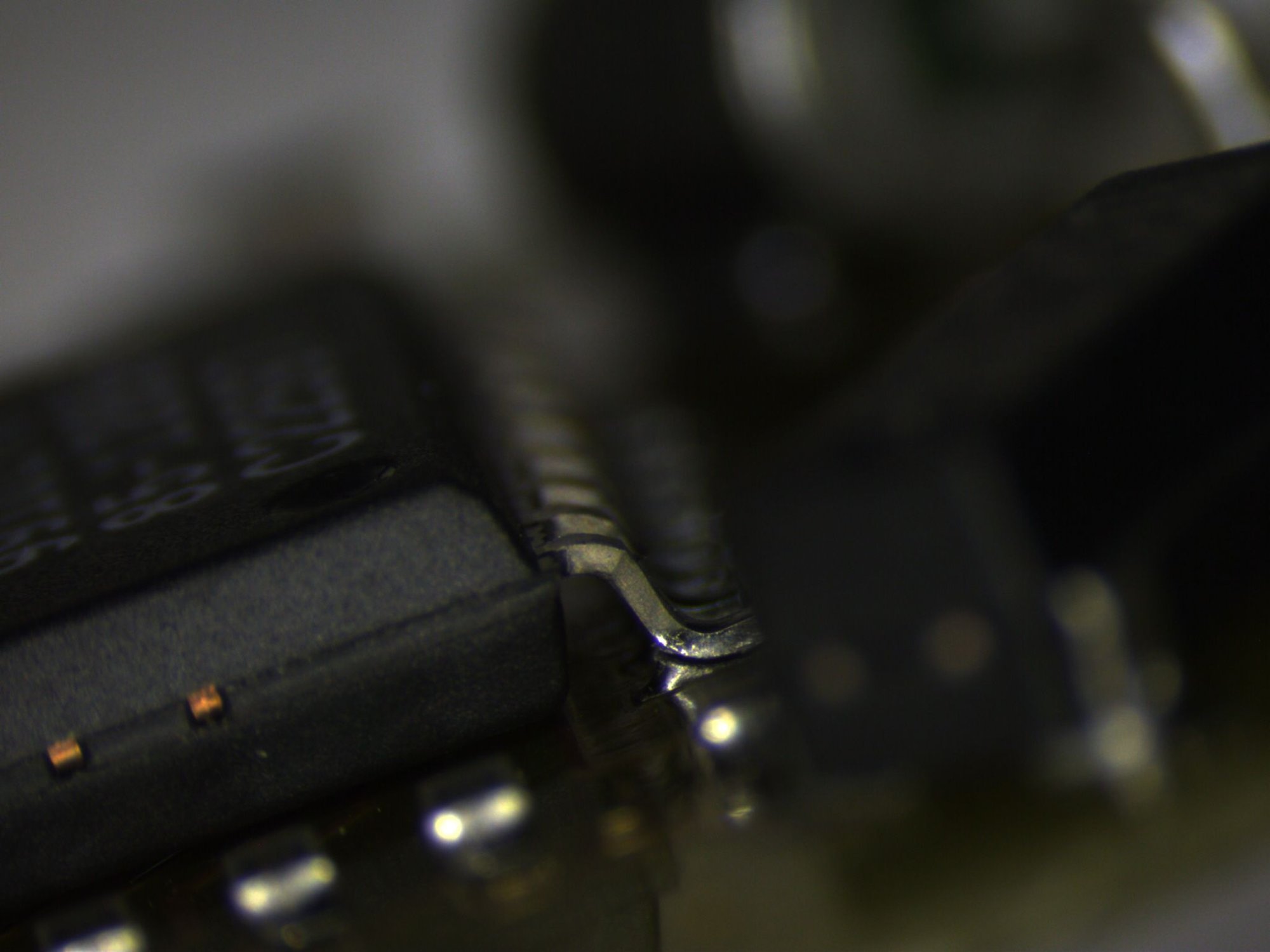

Doubtful it is the receiver. I suspect you have broken solder joints in your fobs. This is a known well documented issue with the early fobs. I had the same issue with my 1999 fob.
If you know how to solder it is an easy fix as all you need to do is reflow the solder to get the fob(s) to work. Below is a pic of what I found in my fob.
BTW, switching to a 2001-2004 set up involves replacing all of the TPMS sensors in the tires as well. Not an inexpensive alternative at all.
Do a search for "key fob fix" to get more info.

you were correct; it was the fobs. on one the component was actually lifted off of the board and broke the trace to the IC. I soldered a small wire to repair it and it is now working. The second one looked OK but I touched the 6 connections mentioned and it is no longer responding. I only need 1 so I'm good, but I will try re-training it to see if that will bring it back.
