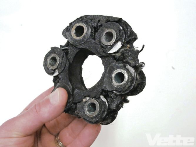

Maybe the torque tube bearings. That's the sound I had when my 98's bearings decided to grenade.

My money is still on the torque tube bearings
