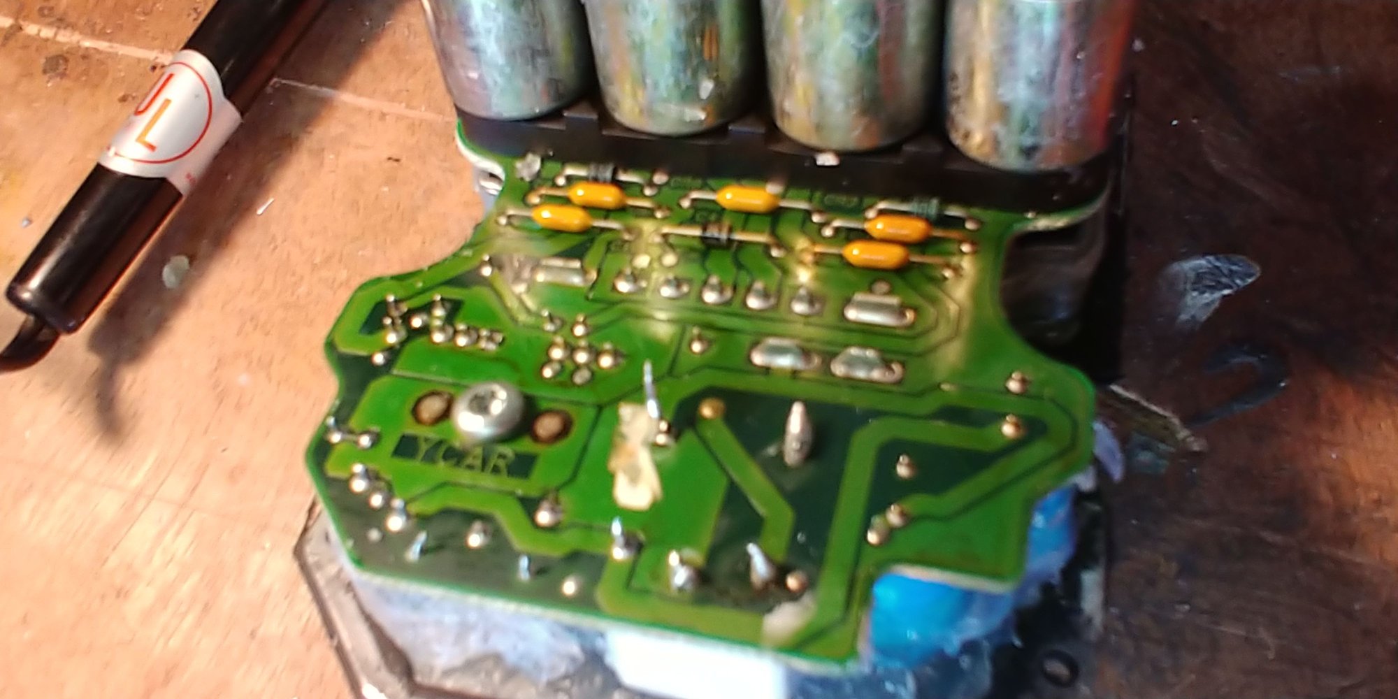

I had a similar problem with the traction control and abs lights on. Removed the center console and the button but if the EBCM needs repair the button doesn't do anything. After I fixed my EBCM the button started working. Here's a link for the ebcm:
https://www.corvetteforum.com/forums...r-fleabay.html
If everything is working correctly button will give you an immediate response and a sound and the d i c will show the status traction control on / off or competitive driving mode depending on your selection. I am no expert hopefully this point you in the right direction

I had the exact same problem and put it off for 6 months it got to the point where the car was all over the road without active handling and traction control. Finally just decided to take it on one day and it took about an hour. Magically the button works again and now I have a problem pushing the button so often that I need to buy new rear tires :-) good luck on your project. This is what mine looked like
