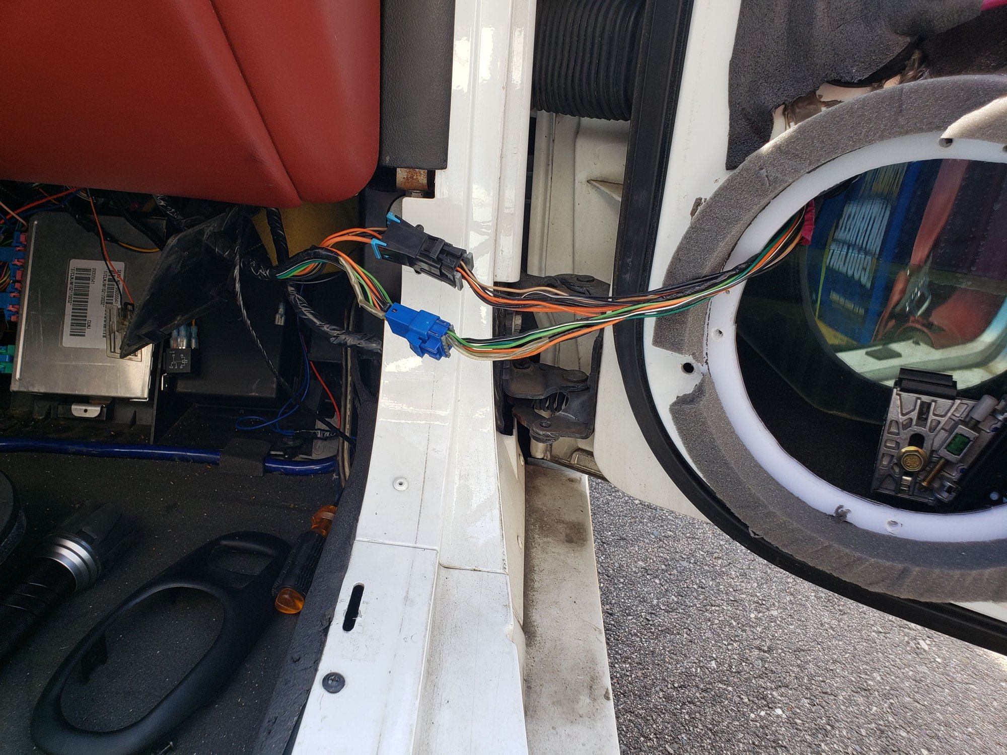

This was picture I took from Sunday when I was trying to diagnose the issue

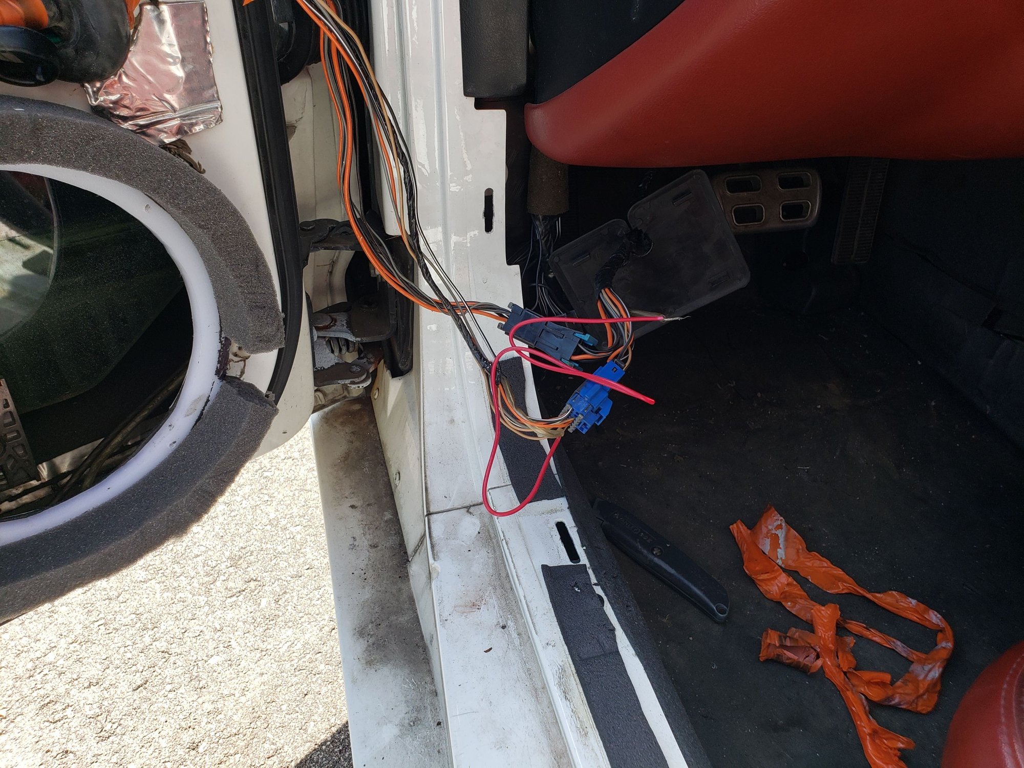

Old Apr 22, 2019 | 05:32 PM
chevbowtie22's Avatar
chevbowtie22
Joined: Oct 2010
Posts: 135
From: Belle Plaine MN
Here is a shot of the driver side with the temporary jumper in place. I apologize for the filthy door sill. It's been in storage for a few years. The deep clean comes after its road worthy. But in all honesty it looks pretty good for 185,000 + miles.
