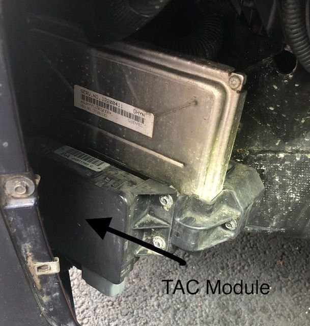

We normally call the engine computer the PCM...also called ECM/ECU...a PCM is not "plug and play" !!...it needs to be programmed...was it ??...in the picture it is the silver colored module !!
