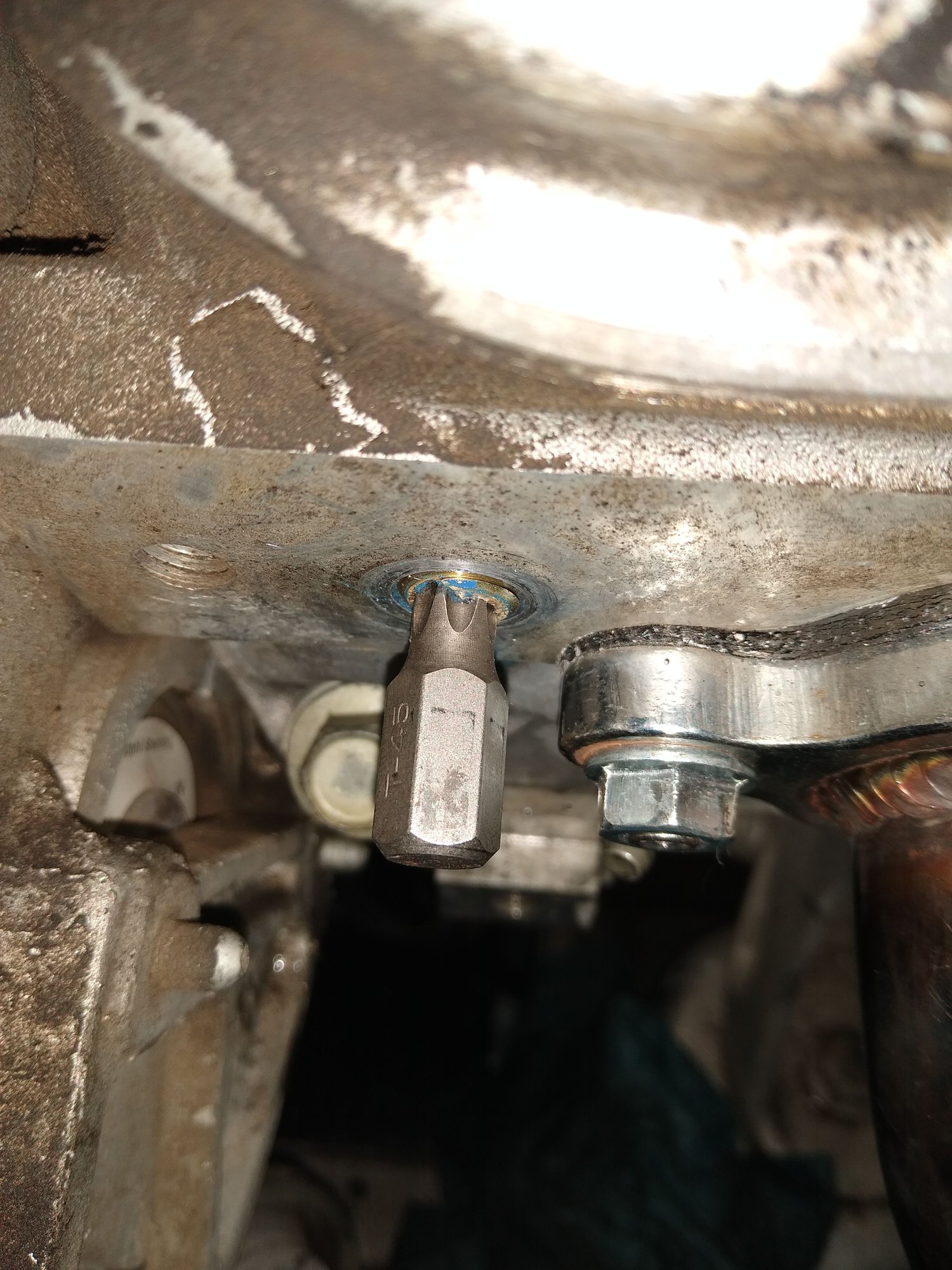

Default Temperature Sensor Broke in Head
Torx T-45 tapped into broken end of temp sensor. Unscrewed with little force.
