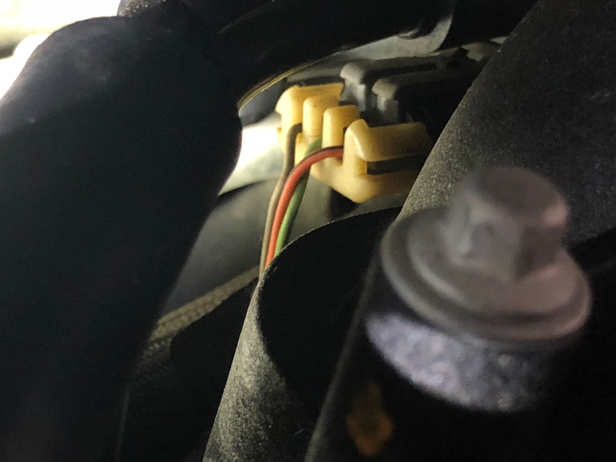

Sounds great !!...testing the MAP is difficult since it sits behind the intake manifold...you can barely see the connector...with a scan tool that can read the MAP voltage it is pretty easy.
Old Apr 27, 2019 | 03:10 PM
Eddie04Z06's Avatar
Eddie04Z06
Cruising
Joined: Apr 2019
Posts: 14
Okay I have tested the MAF wiring and I got the 12 volts and the 5 volts right away. I am going to try to check the connection for the MAP now and will look for leaks as well. Will keep you posted on what I find

Ground was good, got a bright light from the test light. I just checked the plug for the MAP and got 5 volts. Is this good? Or does it need 12 volts? Also since I'm here should I just replace the MAP sensor?

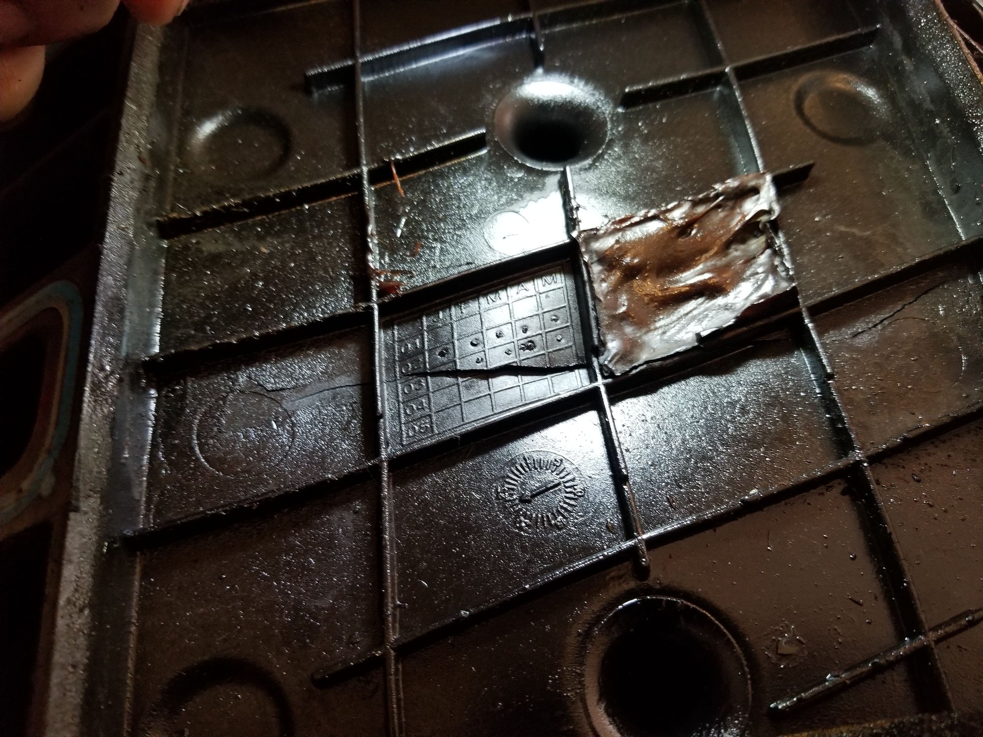

Good News! I pulled the intake because it was so dirty and look at what I found! A huge crack under my intake that someone tried to repair! I'm no expert but im sure this is my vacuum leak! Getting a new one and will update you guys.

WOW !!!...was wondering how you checked that MAP sensor wiring without removing the intake manifold first....GREAT FIND !!...yeah that’s a vacuum leak all right...LOL !!

Oh yeah I tried at first but it was impossible to get in there lol. But man am I glad I pulled the intake and looked at it. Now I'm in the market for a new intake or maybe a good used one and hopefully this fixes the problem. Overall I'm just happy it's not electrical problems lol. The intake is an easy fix. Thank you C5 Diag for all the help!

“Normally” we find vacuum leaks (causing that crazy RPM) around the MAF area but usually we see lean code DTC’s...P0171/0174...without looking at some data PIDS with a scan tool or using a smoke machine to find vacuum leaks this would be a difficult one to find without this equipment !!...and yes the hard sensors to check electrically are the MAP, and the cam and crank sensors because of where they are located...you should probably look at the cam sensor and it’s wiring while you’re back there !!...yes maybe changing the cam and MAP sensors might be a good idea...OEM though !!

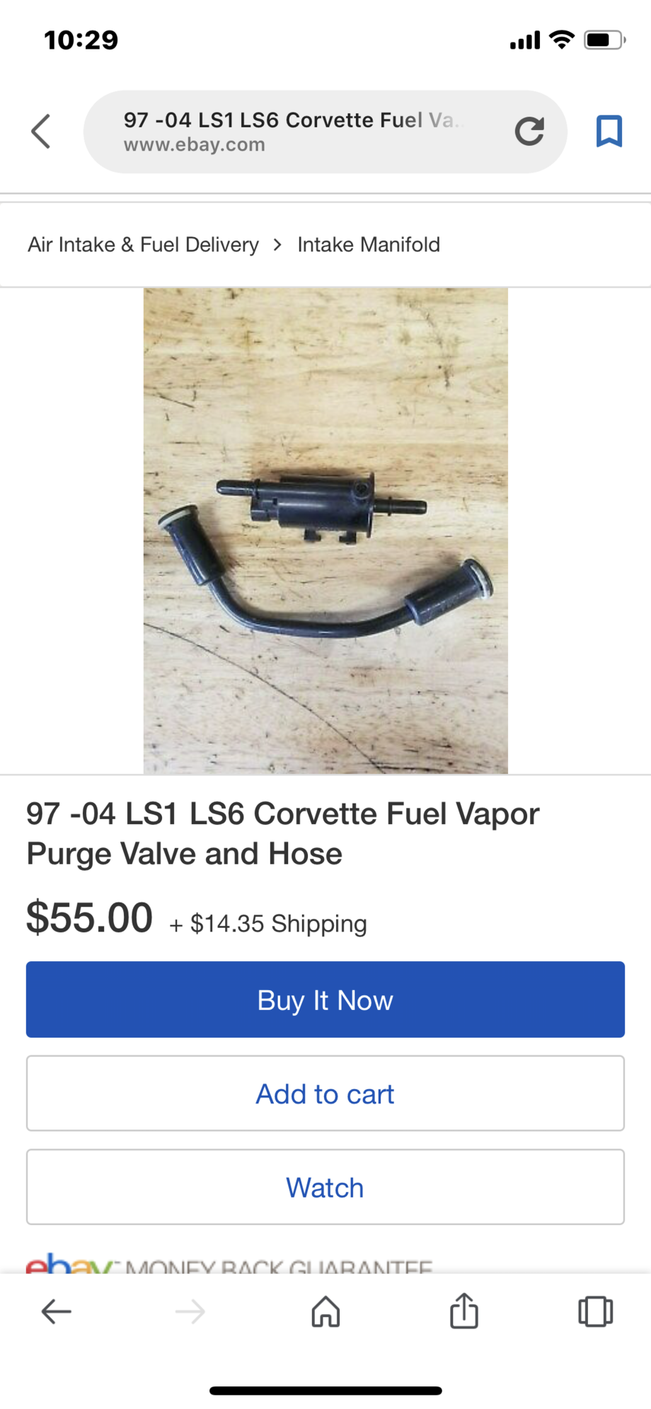

Hello everyone, could anyone tell me the PN of this hose? I broke mine and need to replace it.

This part may be discontinued...you can check GM Parts Warehouse...here is one from EBay !!...you should be able to use some fuel line and some clamps too !!
