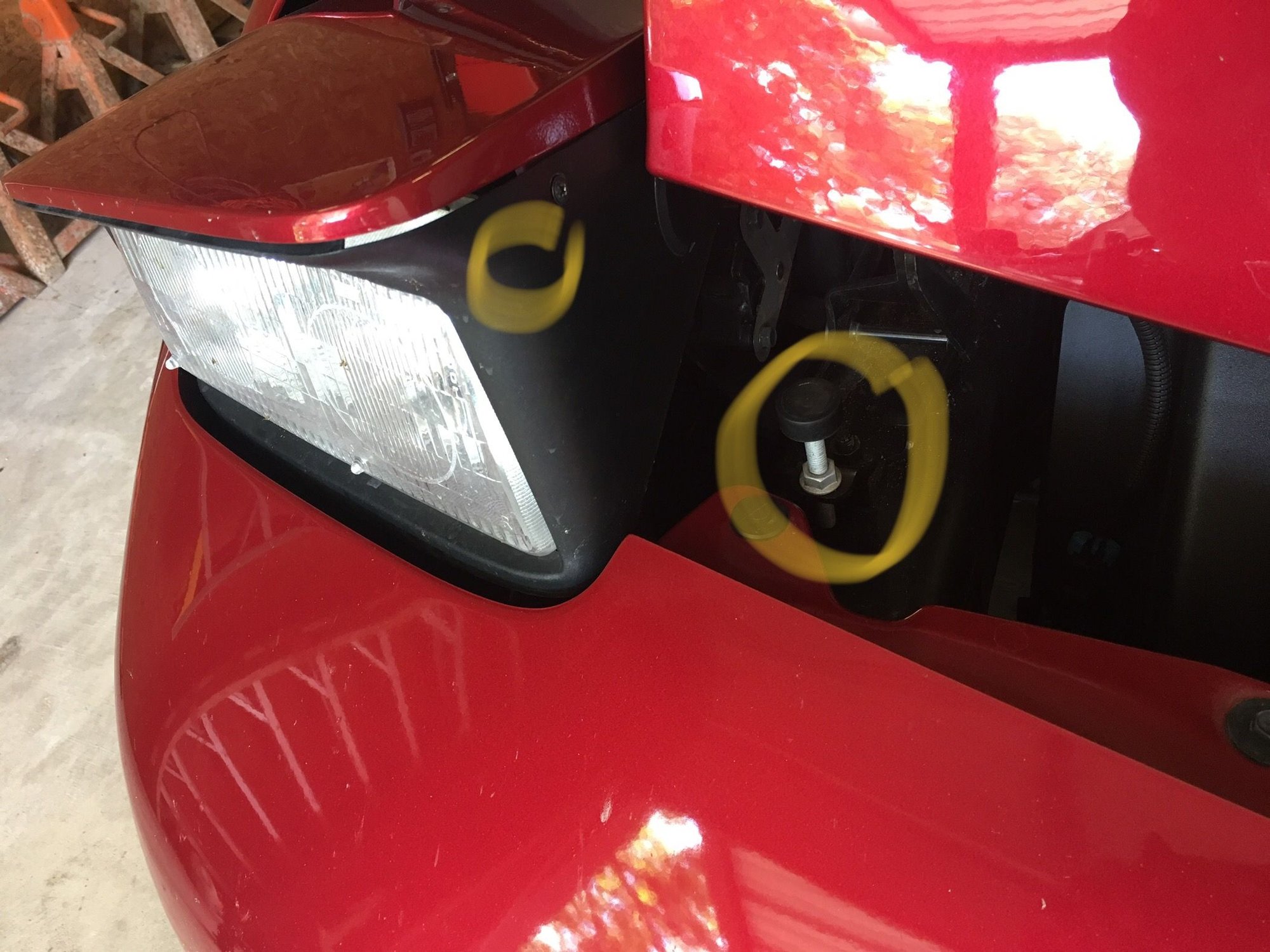

I saw 2 ways to change front blinker bulbs on youtube. I didnt like either one. I temoved the hood bumper bolt (13 mm) and headlight bezel (3 philipps screws) on the side i need to access. With these removed you can reach down below the headlight and twist the socket to access the bulb.
Circled hood bumper bolt snd one of the philipps screws
