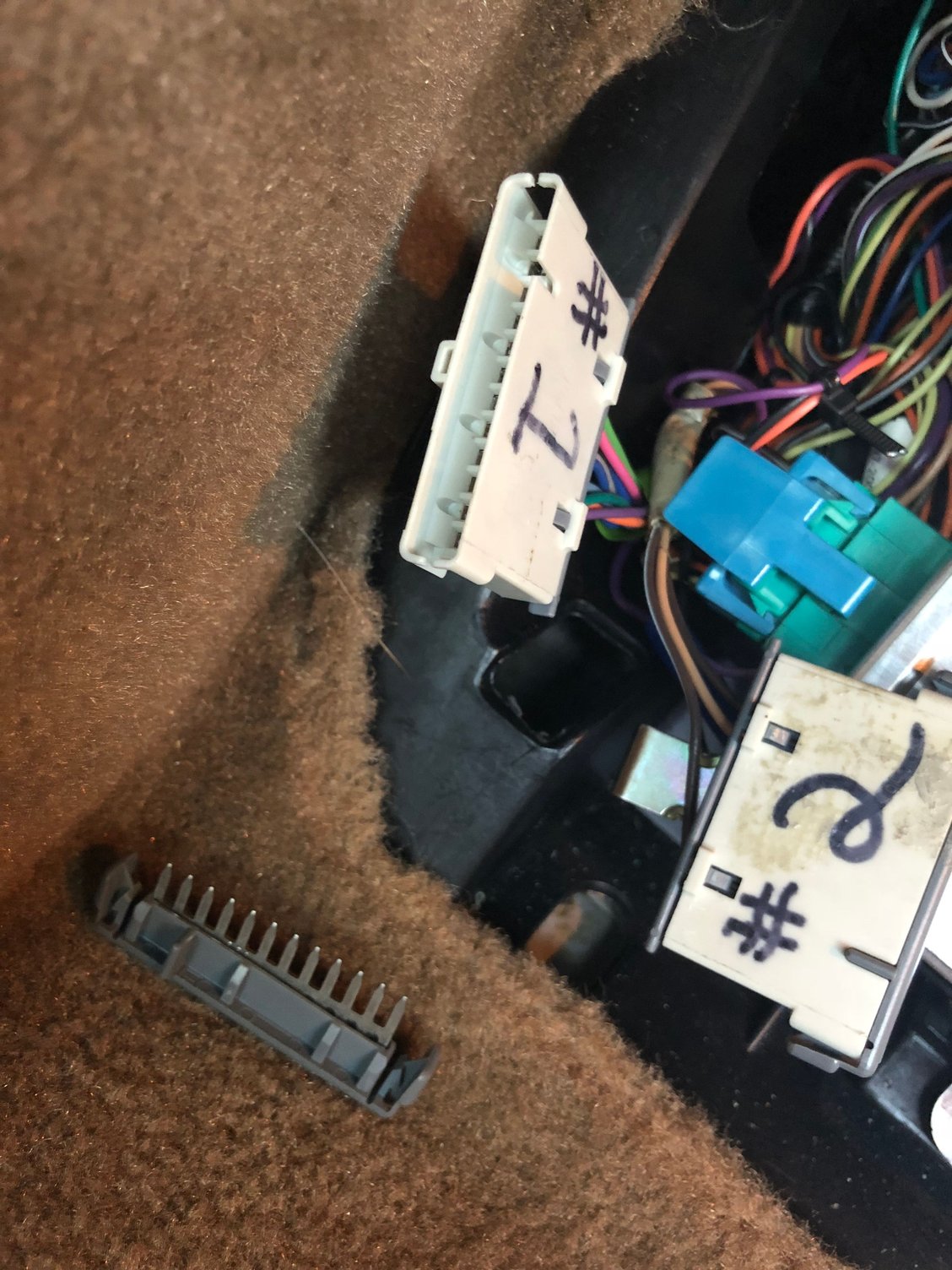

Sounds like the “classic” serial data network issue !!...does the oil pressure also show zero and water temp also max out ??... do you see all the DIC warnings scroll through...reduced engine power, service vehicle soon, low fuel ??...I can show you what to test with a voltmeter on the DLC (where a scan tool attaches to) for a short to power or to ground on the serial data line but for now just find the 2 “Star Connectors” by the BCM...one has 4 wires I believe and the other has 9...there is a shorting bar or “comb” on the top of each...squeeze the top of the one with 4 wires off and now see if the car starts...make sure the comb is clean with no corrosion...I helped someone 2 weeks ago with this same problem...we took sandpaper and cleaned the comb...that’s all the problem was !!...clean it good !!...his comb looked OK visually but it took us a while to figure it out !!...we could only get a few modules to come back online but not some others... if that doesn’t work pop the comb off the other one....clean that comb and reinstall it...see if the car starts...if no pull the comb back off again...to allow the car to start with both combs removed you will need to jump the PCM and BCM modules to each other...the light green and dark green wires together !!...with a scan tool if you have one I can explain how to check which of the 12 computer modules are not communicating !!...what happens is either a module loses either a ground or power internally and the power or ground back feeds to that data line....modules can’t talk and car won’t start !!...we will then check each wire at the star connector for either 12 volts or ground on the data wire... it’s normally a 0-7 volt square wave !!

Don't know if you have a multi meter but when you pop off the "comb" on Star Connector #2 (4 wire) see if you either have 12 volt power or ground on any wire denoting your "problem" module.... you won't see a 0-7 volt signal unless you have a graphing multi meter or a scope...you'll see the voltage fluxuate between .40-.49 or so with a multimeter if it's a good data signal...you should see this on the purple wire !!...the pics are what you will see on the IPC !!

I pulled the comb out of the 4 wire assembly. My car started instantly. I checked the comb and there was very minimal corrosion. I then pulled the comb on the 9 wire assembly and noticed the same thing. I pulled at a fine nail file and removed all of the corrosion on both combs and reinstalled them.
With both combs reinstalled, my car wouldn't start. Now I need to find my multimeter and check out that purple wire.

The issue is on the 4 wire Connector...you'll probably find 12 volts or ground on either the seat module or the 2 door modules data wires !!....you're almost home !!...on the purple data wire you'll see the voltage fluctuate around .4 volts or so...the other wires is where you'll see either the 12 volts or short to ground...the seat control module is brown/white, the driver door module is brown, and the passenger door module is tan !!

I got to some brighter light and saw that there was still a little bit of corrosion on the pin for the purple wire. I removed it and things are fine!
