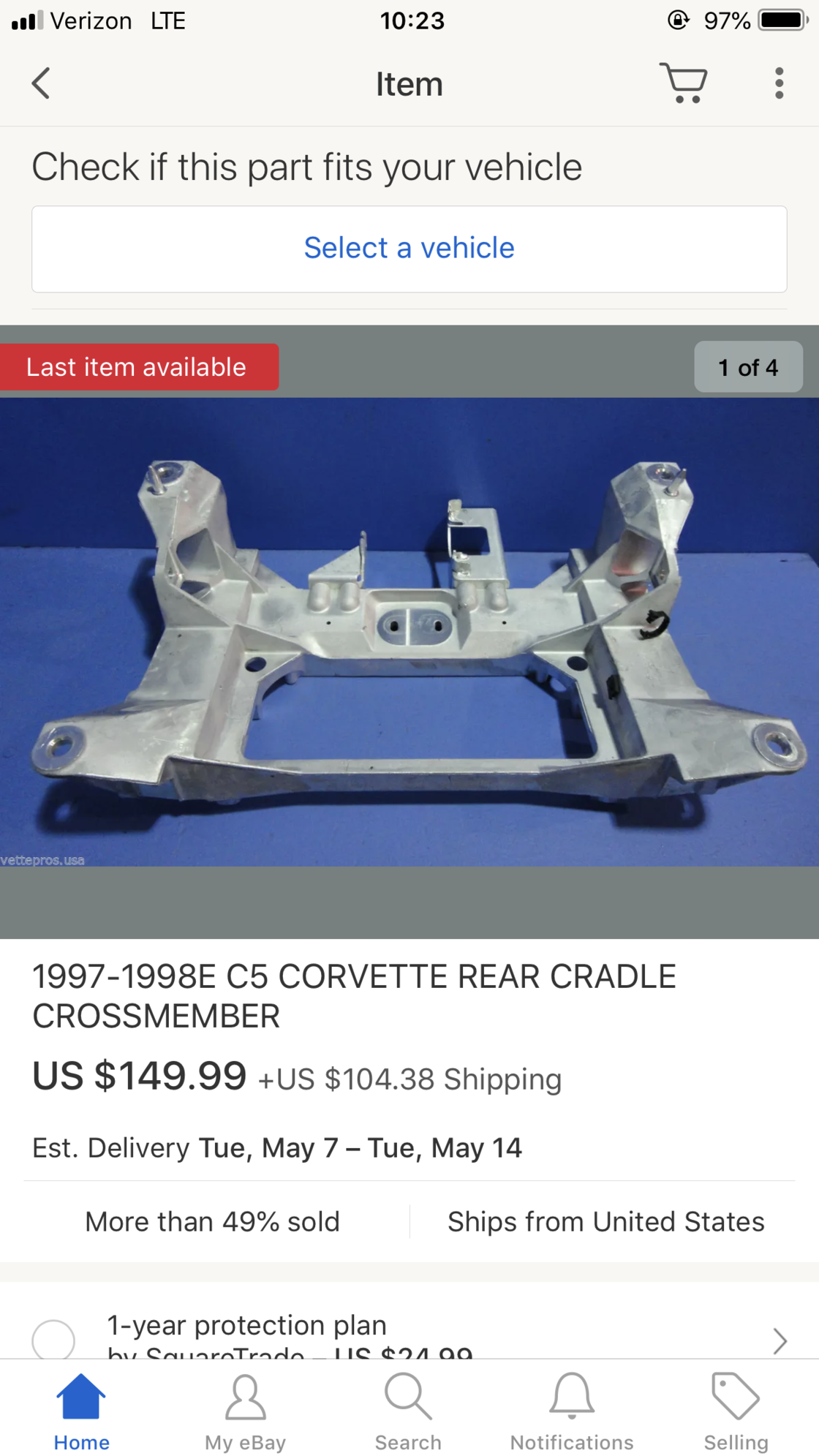

So, I would be able to just buy this part with the bracket and attach everything else?

The rear cradles between front mount ABS and rear mount ABS are structurely different, see below difference.
............. That is correct!
