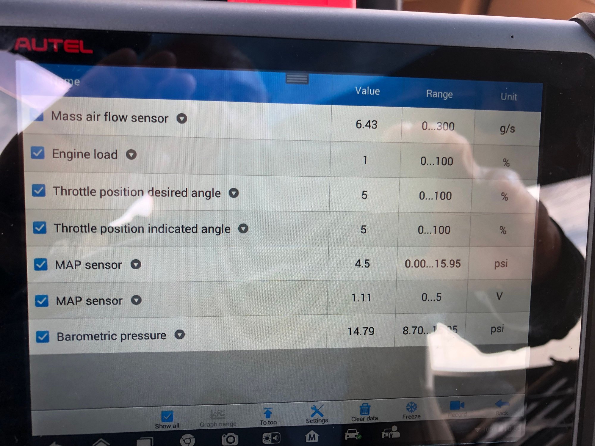

Originally Posted by z06 kyle
Yeah all 8 injectors dropped to 0 psi once the injector energized. I’ll take some more pictures of the MAF specs tonight and I didn’t have an extra person to look at the scanner while I was spraying the propane. I was listening for the change in idle.
Really should check those injectors...there are injector "pulsers" on Amazon for $35.00 !!

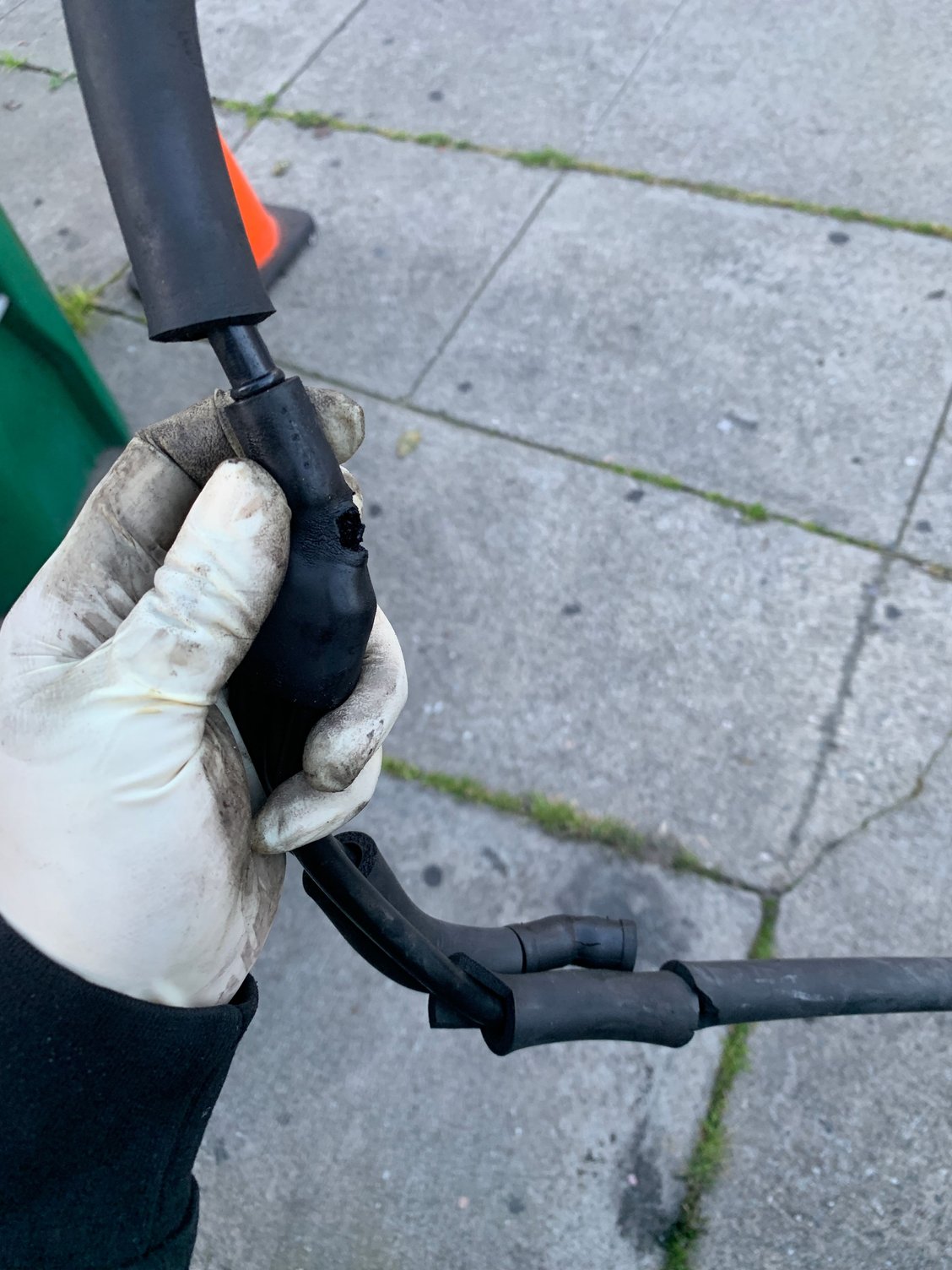

Mine had a misfire problem too after trying and testing just about everything I could think of I started to take the intake manifold off to change the gasket on it to see if it changed anything I came across the pcv line which had dry rotted in the back I would of never seen it since it was hidden I changed it and know it drives great
That’s ls1 pcv routing. The ls6 doesn’t have the routing that ties in both valve covers. I know because I used to have a ls1 camaro

The 01-04 ZO6 (LS6 engine) does not have that PCV Pluming. The C5 97-2000 LS-1 engine does use that same PCV Pluming and YES,, it does rot/crack and fail. Very likely source for a LS1 vacuum leak if you are have one on the early cars.
HOWEVER,, The 01-04 cars can also have a serious PCV leak on the very short piece of vacuum line that connects the valve to the TB. Seen it tooo many times to count. That short piece of runner line can rot and crack too. That PCV assy is on the passengers side of the intake manifold at the front just aft of the throttle body and it connects to a fitting on the valve valley cover.
Have pictures of it if you need it.
Bill

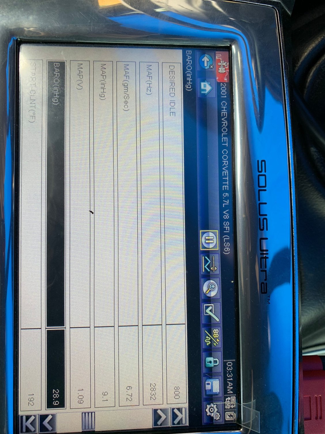

Originally Posted by C5 Diag
MMM ??...I think you said you cleaned your MAF but it may be a MAF sensor..,the Solus should be able to show MAF grams/second and frequency...here is a snap shot of my 01 at idle...compare them to yours !!
The bark and map sensor don’t seem to match up with yours. Could this be the problem?

From: Norco CA
Scratch that just realized yours is in psi lol

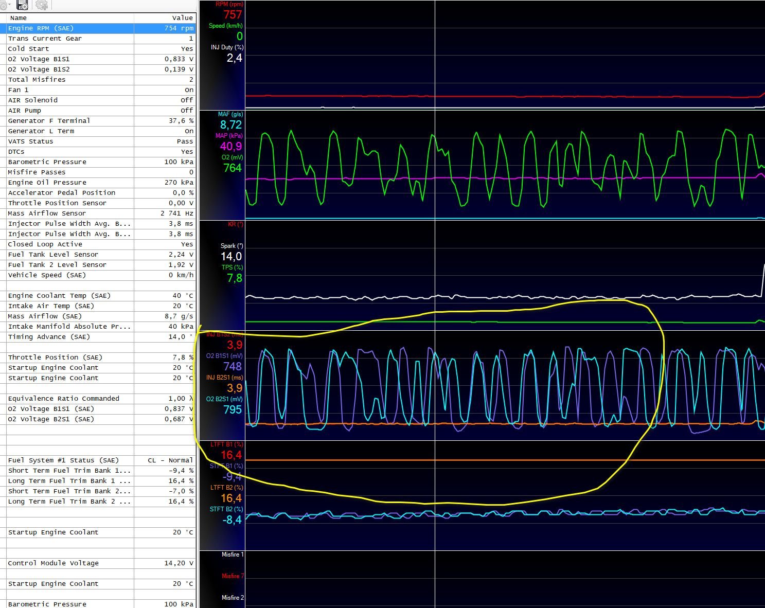

Sensor 1 in bank 1 and 2 should fluctuate between approx. 0,1-0.9 volt in idle .
Sensor 2 in bank 1 and 2 should not fluctuate when the cats are Ok .
When the rear sensors get similar activity to the post catalyst it indicate that the catalsyts efficiency is degraded
Here is from my car

Oelarse is 100% correct. With the cats hot and at higher rpm the downstream is fixed...if it switches like the upstream you may have a bad cat..,it is not storing oxygen ...Now you said the bank 2 downstream remains near 500mv...a good O2 downstream sensor waveform will usually be a little on the “rich” side and read somewhere between 600-700mv...my downstreams with my cats hot at around 2000 RPM reads around 725-750 Mv !!...the 500 Mv reading you are seeing may be reading your “bias voltage” which is around 450mv...you might have an open in the signal wire or a bad O2 sensor...if at idle if you snap the throttle both upstream and downstream should momentarily go rich...see if yours remains at 500mv and remains fixed...,to test disconnect the O2 sensor and with the scan tool connected take a 12 volt test light connected to ground..,touch the tip of the test light to the signal wire...if the sensor shows 0mv on the scan tool the signal wire is good and you have a bad O2 sensor...if test light does not pull the signal to ground you have an open in the signal wire...you said the car ran better with your MAF disconnected...if your long terms are high and you run the engine at 3000 rpm and the long terms decrease over a few minutes ( the short terms will quickly go negative ) YOU HAVE A VACUUM LEAK..,if the long terms and short terms stay high you have a bad MAF or fuel delivery issue...using a scan tool is of NO help if you don’t understand the data you are looking at !!...does the scan tool show any misfires...if no misfires showing in OEM (enhanced OBD2) go into generic OBD2 and see if any misfires there !!
