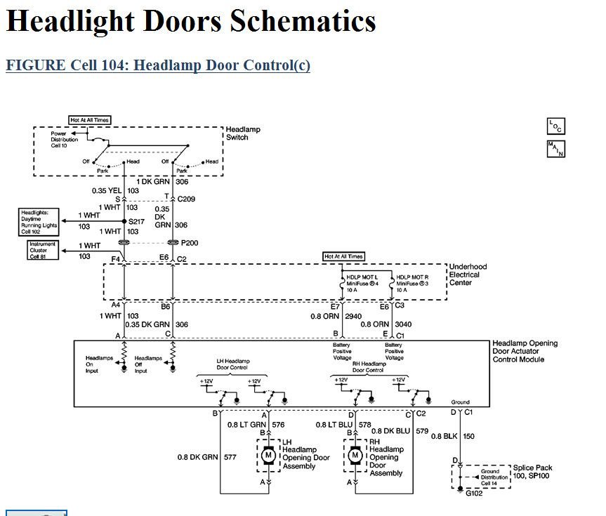

I am sure this has been covered many, many times.. I however can not find an answer.. I have a 1998 C5 convertible, the head lights will not pop up. If I rotate the head light switch over and over then they will eventually both pop up. I do not hear the motors running, When I turn the switch the parking lights will work, I can hear the relay #44 in the passenger foot well click when I rotate the switch , the fog lights will come on but the head lights will not illuminate or pop up. I checked the fuse #6 in the passenger foot well fuse box as well and it is good. I am thinking if it was the switch then the parking/running lights and fog lights would not illuminate. I'm am thinking the head light control module ?

No headlights most likely means fuse 54 in the passenger footwell fusebox is blown. The headlight door open signal and headlight power is the same source.

Check if you get 12 v( battery voltage ) to the control module whenyou switch the headlight switch on .
Maybe the headlamp switch need replacement

Most probably it is the multifunction switch (MFS). It is a known point of failure.
As mentioned above, power to the headlight bulbs is also the signal to the headlight door control module (HDCM) to open the doors. No headlights turning ON means no signal to HDCM.
In addition to that, the fact that sometimes you get them to work after actioning the MFS multiple times, means that no fuses are blown and more likely the contacts inside the MFS are defective.
Getting parking lights and foglights doesn't mean the MFS is fine. Remember that it has multiple contacts for different functions inside, and not all of them go bad at the same time.

I manually relieved the pressure against the bump stops and still no dice! I then opened the head lights manually fully open and if I pull back on the stalk for the flash to pass, the high beams work. I checked the under hood fuse box . both #3 and #4 fuses(R&L head light )motor fuses are good and both have power with the head light switch turned on. I then checked the L&R high and low beam fuses all have power and are good.
I then started to turn the head light switch off and on with the engine off .. nothing.. then I started the engine and after turning the head light switch of and on repeatedly the head lights will turn on and raise. and when switched off they will retract. I then tried repeatedly to turn them off and on and they would open and retract with the head lights working! I then shut off the engine and the lights would illuminate and open and retract few times , then they would not open again until the engine was running .. Both still require a multitude of twisting action to work..
I am in agreement that the MFS switch must be the culprit. I am not sure other than more amps why they will not open when the engine is not running.
I will order one and install it as the weather permits.
I thank you all for the information and guidance.

When the engine is running, the voltage available is higher, which means it has more "energy" to jump across a bad connection.
Yes, from your description, the MFS is the most likely culprit.
