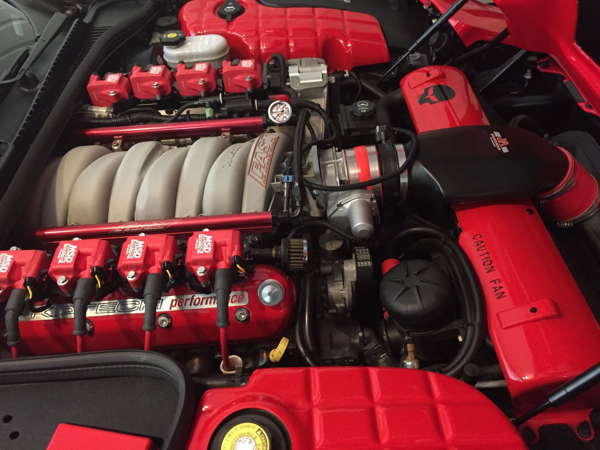

Here is the one I'm using. It's easy to drain when needed.
https://www.corvetteforum.com/forums...n-85516-a.html
Steve

It kind of depends on how you drive. In normal driving I'd say it collects 1/4 cup over 1k miles, but if you do alot of spirited driving or sustained high rpm driving such as track usage you could get 1/4 cup in 100 miles or less. It's a fairly large reservoir that'll hold almost 1 cup of oil. I installed mine after installing new intake gaskets and cleaning my intake manifold and TB. It's amazing how much oil gets sucked back into the intake through the PCV system.
Steve
