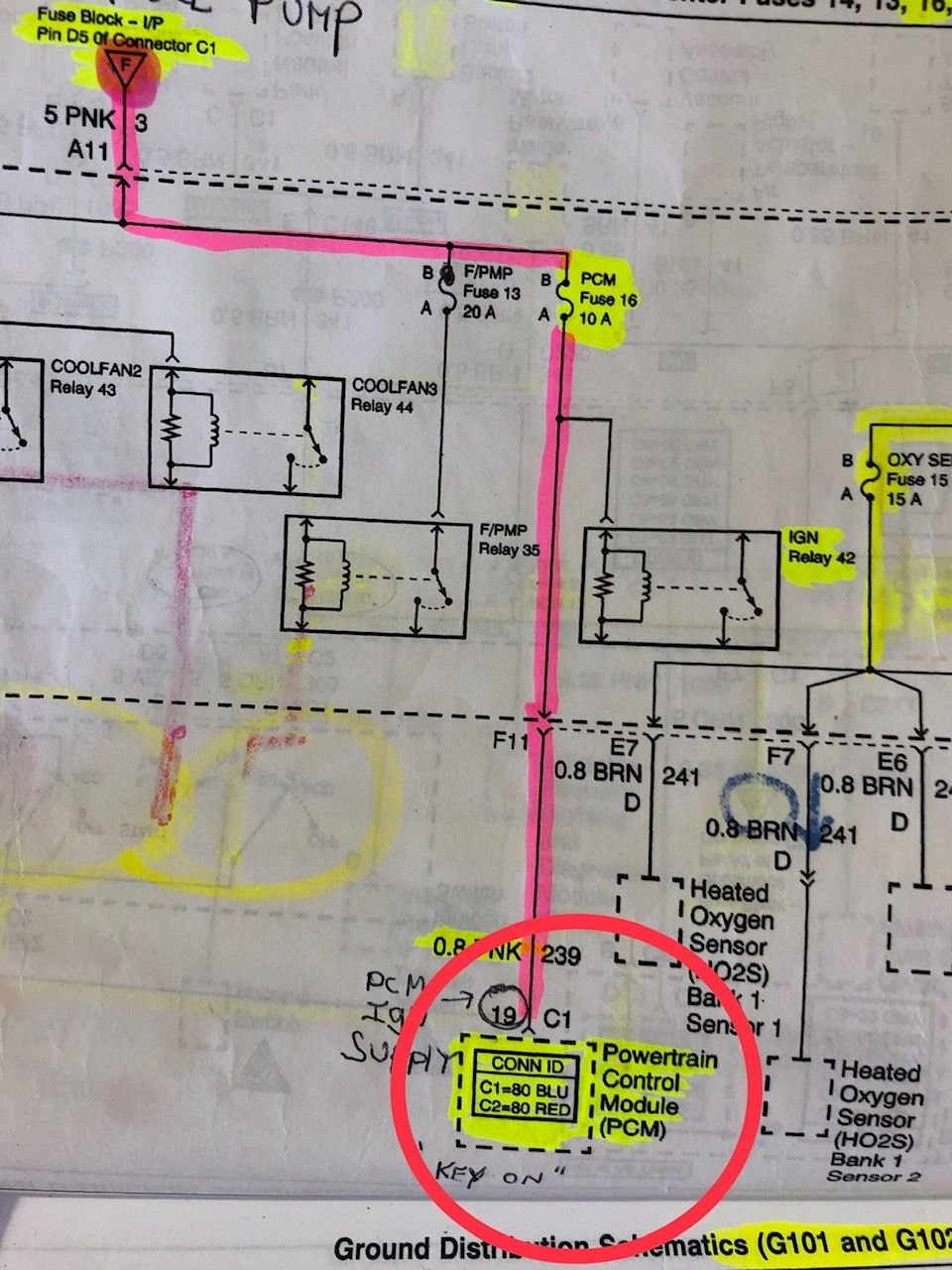

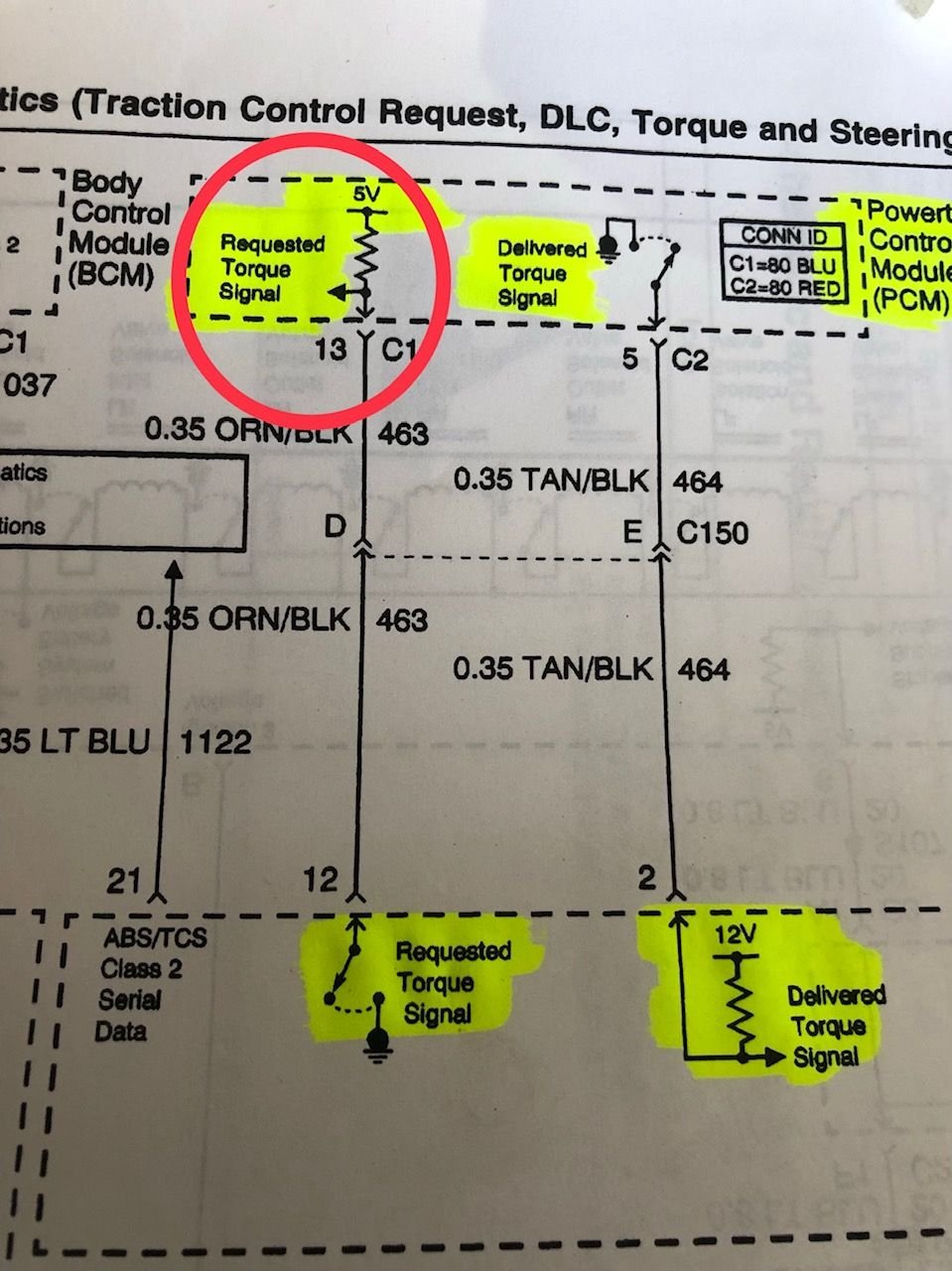

Now I'm THINKING and that can be VERY dangerous but when you are saying the car "cuts off" you mean you're driving and complete shutdown ??...with the 1571/1277 and 0101 I think we are losing the 5 volt ref. which comes from an internal regulator within the PCM (see pics)….trying to figure out how the BCM and EBCM comes into play here...I'm thinking maybe another bad ignition switch...see what your battery voltage is and then turn the key ON and see what the "voltage" reading is on your DIC...if the battery is 12 volts and you read 6 volts or something a lot less than 12 you most likely have an ignition switch issue...JUST SPECULATING !!...might be a good idea to check ALL the PCM power and grounds...this could be an issue also...while you have the key ON remove the connector from the MAF sensor and see if you have 5 volts on the YELLOW wire...that is a 5 volt reference...at least we will know if the PCM is ALIVE !!…"IT'S ALIVE" !!...the 5 volt ref. is the MOST IMPORTANT voltage in the car...its life blood !!!...trying to figure out the BCM "no comms"...MMM ??...oh, this wiring is based on an '01.
