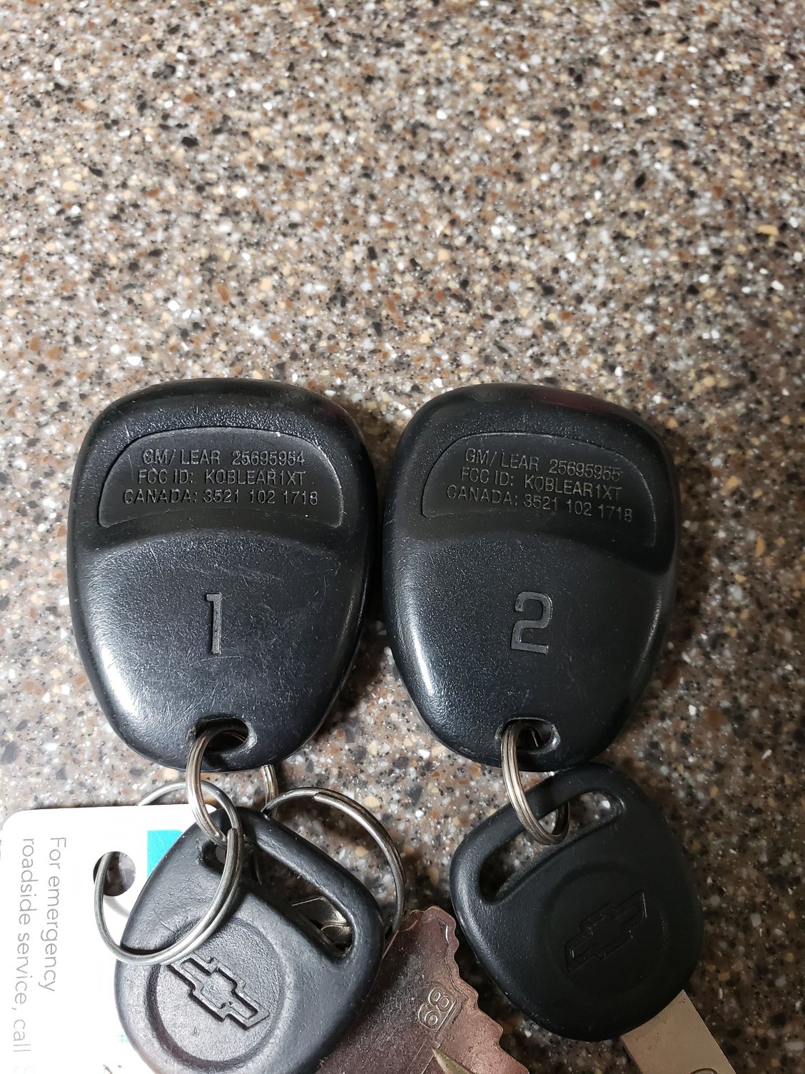

Did you look at the back of the fob to make sure you're programming the correct one?

Fob 1 goes with programming #1 on the door for memory as fob 2 goes with memory #2 on the door.

Fob #1 should be memory button #1 and the other fob should have a #2 on it to go with memory button #2.

Makes sense. So if you re-program all fobs does the order in which you program them make them a #1 or #2? asking that because I purchased a new fob and programmed it....then I reprogrammed the one that has #1 on back - so would my 1 now be a 2?
Yes, I believe this is the case. The number is for keeping track of the fobs after the fact but you have to program them in the right order to begin with.
Yes Sir, think I just found that out.....
