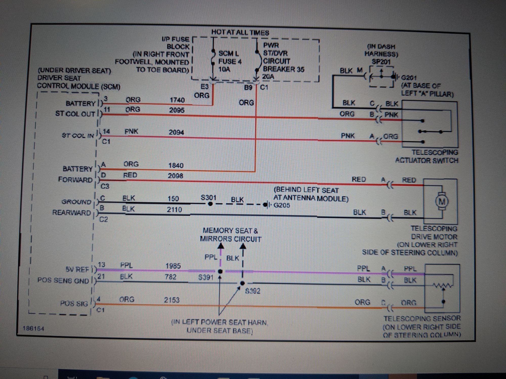

I recently purchased a 2002 love the car but have an annoying problem that I can’t solve. When I make the power seat tilt up in the front with the switch on the side of the seat the telescopic steering wheel moves out. And conversely when I tilt the back of the seat down the telescopic steering wheel goes in. I have replaced the seat module with a correct for my vin working unit, I purchased a brand new seat switch, I’ve verified that the switch on the telescopic wheel has no broken wires. I’ve even replaced the harness underneath the seat. I’ve checked the seven pin blue connector multiple times for continuity. The memory function works fine and the seat moves in all the positions it should...but for some reason I cannot control the steering wheel from the switch on it. I’ve tried to use the reset technique, but no go. The only thing I found that is strange is the pink and orange wire from the blue connector that goes to the switch on the steering wheel are reversed. I did find a diagram online that shows two different types of connectors were used with the wires reversed. I did try switching the wires but no effect. Somehow, making my seat move up or down is sending a signal to the steering wheel to move in or out. Is the most likely suspect at this point a bad BCMThanks for any ideas

It looks like the seat control module (SCM) directly controls the drive motor. The steering column switch only provides a ground to the SCM to tell it to move the steering wheel in or out. You should verify with an ohm meter that the black wire at the steering column switch harness is connected to ground, pin C and that the switch is working by verifying continuity between pins a and c and b and c of the switch. The continuity of the wiring between the SCM and the switch should also be verified.

That’s what all signs seem to point to I did verify that the switch on the steering wheel is creating ground in fact I hotwired it directly to the ground of the battery and then verified that the wires that I hooked up had continuity. I guess this is what happens when you buy a car at the dealership With no know history...however I got an almost brand new looking 46,000 mile electric blue Corvette that started at an asking price of 15 8 for 10.3. Sure I had to repair one headlight motor and the AC panel and two door locks maybe all in so far 700 additional dollars
