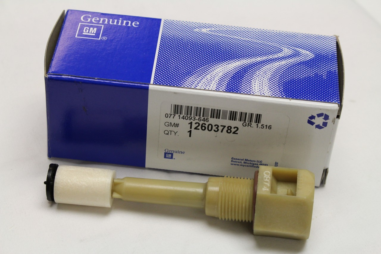

try replacing the sensor next time you change the oil.

One quart low when mine came on. Scared the hell out of me until I checked the dipstick and saw it was only one quart down. Ordered a new sender just in case but didn't have to install it. Only cost about $20.
