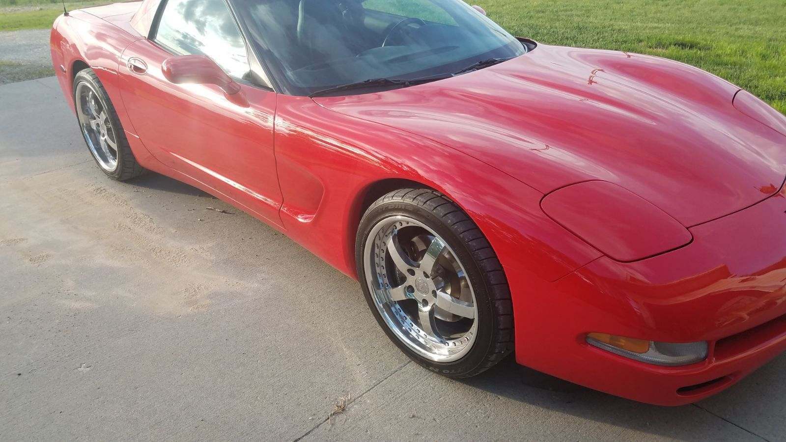

My question: do you see any potential problems running a 275/30/19 on the front, with a 305/30/20 on the back? Is this ratio to far off? thanks in advance for any help!

You should be fine, with that combo. Before I replaced my tires a few months ago, my car had 275/30/19 fronts and 295/35/19 rears and never had any issues.
275/30/19 = 25.6"
295/35/19 = 27.1"
305/30/20 = 27.2"

They should fit, but the extra size and mass may make your car feel sluggish. Just be aware...
I went up 1” diameter from stock in the front and rear with the same widths as you. I can tell a big difference in dynamics with the bigger sizes. I run smaller sizes at the track for that reason.

To be honest the wheels I went to are a used set of Iforged Aero wheels. The wheels, though larger, actually feel physically lighter than the stock 99' wagon wheels on my FRC when I lift them in and out of my truck. I am actually taking them back off though, because I don't like the steering feel of the much wider tire up front in parking lots and such. Down the road is just great. Probably doesn't hurt that there are new tires all the way around. It looks totally cool, but I bought it to drive, not just look cool. I know there are other people on the forum running these sizes, and love it, it just isn't for me. Live and learn. They will be going up for sale later this weekend. Thank you for your input! Mike
