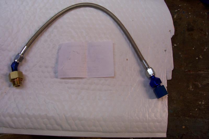

Isn't someone selling a kit to relocate the sending unit ? Mine is leaking again and want to put it in a better location.

Build your own it's cheaper...

Yup, better to make your own.
https://www.corvetteforum.com/forums...l#&gid=1&pid=3
https://www.corvetteforum.com/forums...se-days-2.html

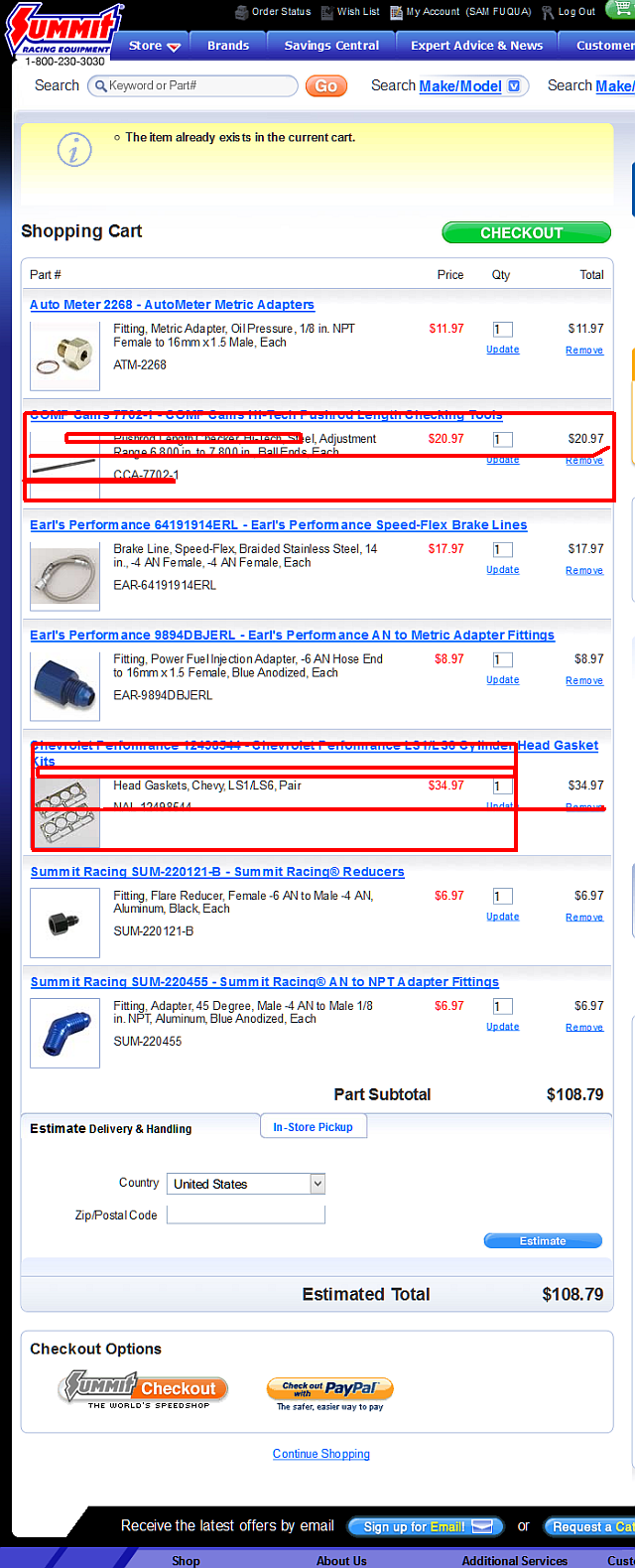

Okay I went through Summit and ordered everything. Thanks

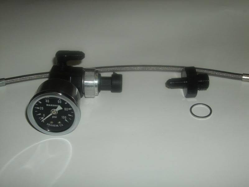

I made these a few years ago and have some fittings left over. I would like to get rid of these that I have left if anyone is interested. There aren't as many connection points as most of the kits available on the market, which means less possible leaks. There is a single fitting with a crush washer at the engine, then a stainless flexline going to a manifold type fitting. The manifold has two 1/8 npt open ports and then an open port on the end for the oil pressure sender. I used one of the ports for a 90 degree fitting connecting to the flexline going to the engine fitting and the other port for a liquid filled gauge. The are also two mount holes on the bottom to mount the manifold. I made a small bracket and mounted it under the left /driver side cover. I may still have some of the 90 degree fittings, plugs (if you don't add a liquid filled gauge), and possibly some gauges. I mostly have the machined engine fittings and the machined manifolds. Everything was machined from 6061-t6 aluminum and then anodized black to protect them from the elements. If anyone's interested send me a message.

So nice I’m building one this week.

Thanks for this post....I ordered everyting, but in black.....I have to pull my intake manifold for other reasons so why not. My sender works fine so I will reuse it and just needed to buy these parts.....great post

Got everything delivered today, I also got the extender for the wiring.

that's a nice looking set up! Sent you a message!
