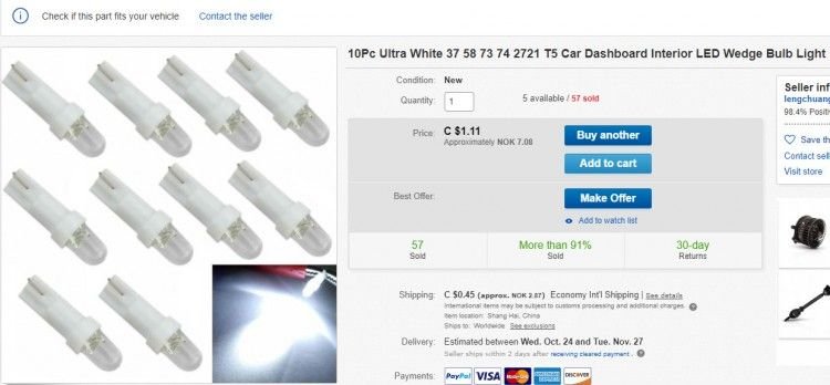

I replaced my bulbs with LED´s in my sun visors , glued the pieces back together and put new sun visor leathers covers on the sun visors .
I am very satisfied with the result
