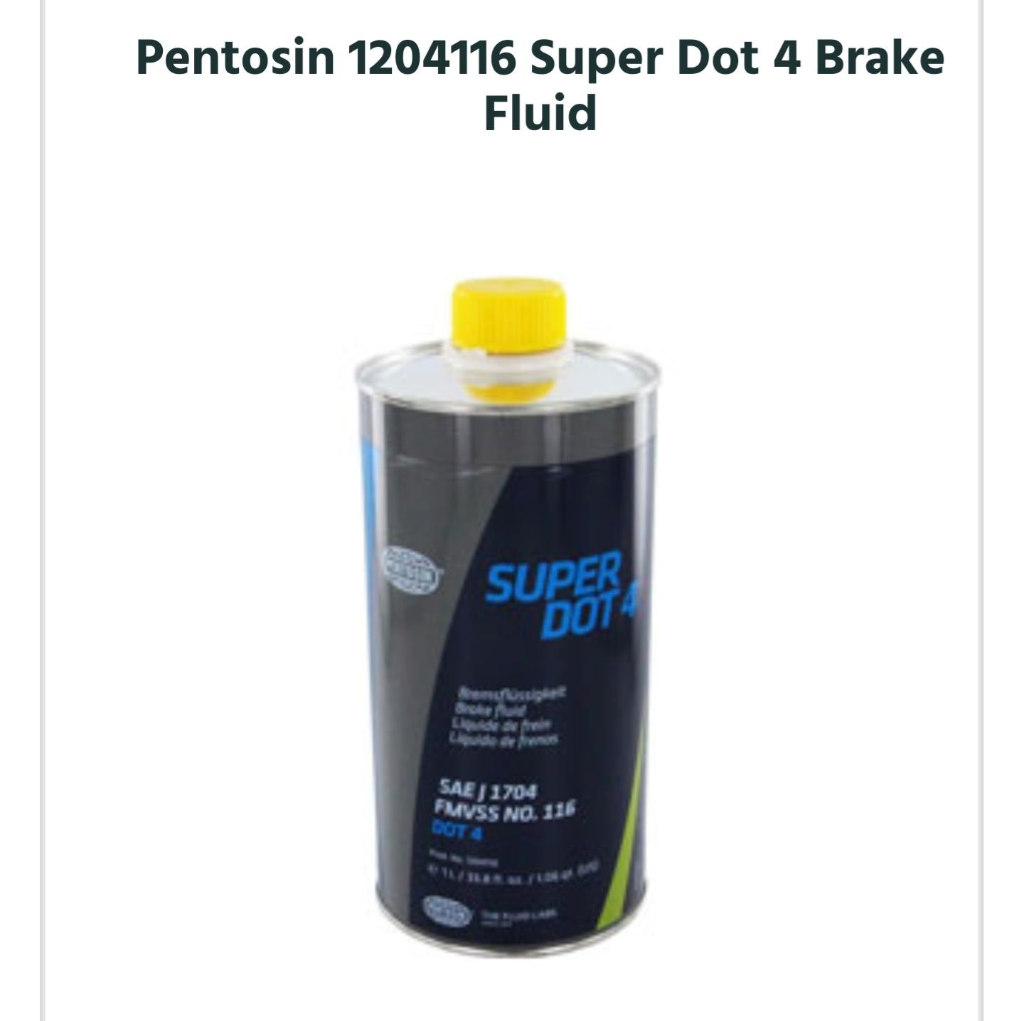

I have an 01 Z06 with 47k on it. During spirited driving the clutch pedal will fade and start engaging just off the floor. I did have it checked and I was told it's common with the C5 Z06. In order to fix it you will need to upgrade your clutch. I did the ranger method and changed my fluid. I used Pentosin Dot 4. The dot 4 did improve my clutch pedal.
