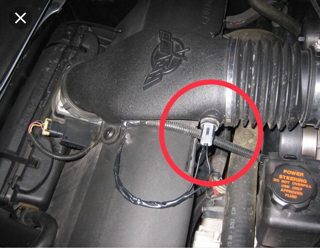

Congrats on your purchase !!...All but one...the P0113 are “history” codes...P0113 is a IAT “circuit high” issue...now you said you brought the car to your “shop”...what kind of shop...automotive, body shop ??...if neither do you own a DVOM ??...IAT is a simple 2 wire thermistor so it’s basically a 5 volt reference voltage and sensor ground...if you have a DVOM and would like to know how to diagnose it let me know !!

The IAT sensor if bad can cause those starting issues plus the active handling warm up !!...let’s do this test...disconnect the IAT sensor and with key ON see if you have 5 volts on the TAN wire I believe...if good voltage plug the sensor back in and get a safety pin and from the back of the connector probe the PURPLE wire from the back side...
there should be a little gap...we call this “back probing”...this is the sensor ground...if you see 0 volts you have an open in the sensor...replace it but with an OEM one !!

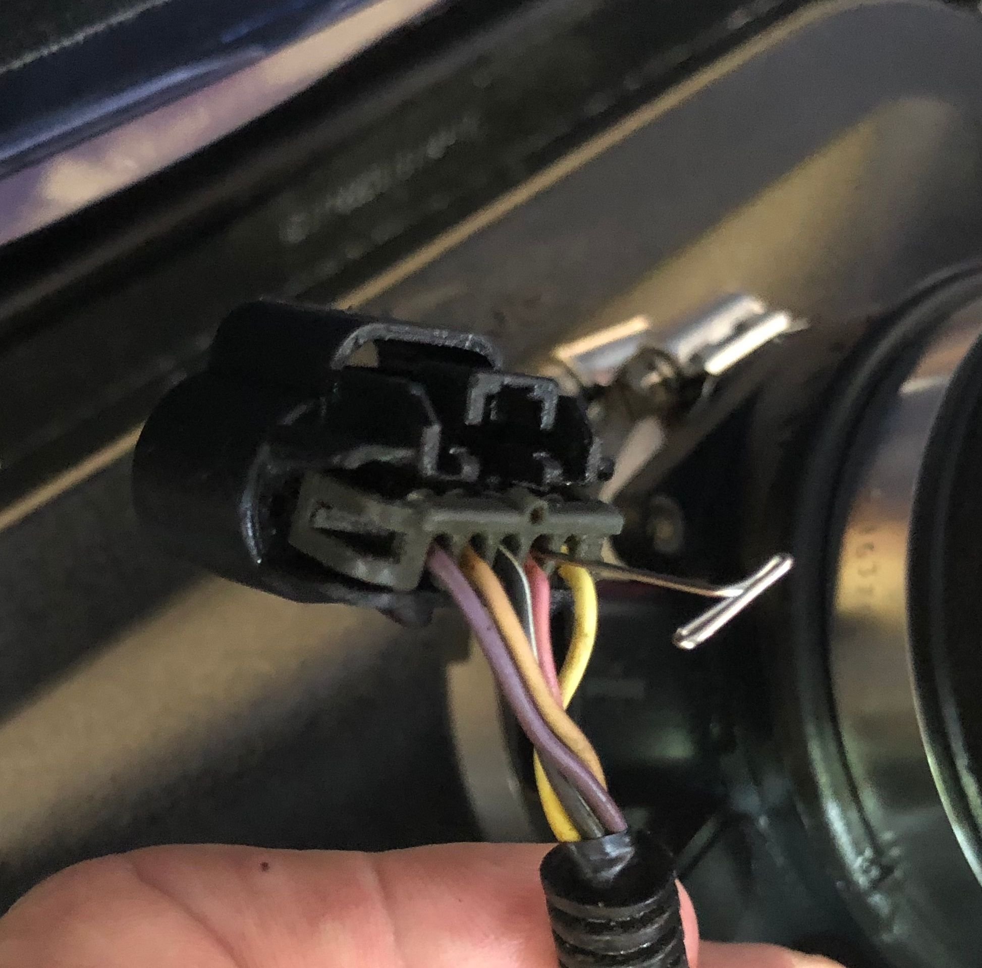

I just got back from my shop. I unplugged the sensor and checked current on the mating side. Neg to purple and Pos to tan. Showed 5 volts. Plugged back in and chased down a back-probe kit. I've never back-probed so am unclear as to what you are touching pos/neg probes to? Thank you very much by the way! Jumped head first into the Corvette world.

If you connected the DVOM between the 2 wires and are reading 5 volts the wiring is good !!...to verify 100 % that the IAT sensor is bad remove it and connect the DVOM between the 2 IAT sensor pins and select OHMS...get a hair dryer or heat gun and heat the sensor...you should see the resistance decrease...if not the IAT sensor is bad!!

Update: I pulled the AIT plug and confirmed 5 volts coming through the plug. Deleted all codes last night and went for a drive. High voltage codes came back. Pulled the sensor this morning to test. Checked out good, reinstalled, cleared codes and went for a drive. No codes present now after start stop half dozen times. Kind of at a loss. I'll probably throw a new one in due to the fact that the car is 20 years old. Only code I have been throwing now has been for the telescoping wheel.

Since you tested the sensor and it’s good it’s more than likely just a bad connection...I’d connect the voltmeter and start shaking down the wiring...most likely it’s right where the harness plugs in is where it may be faulty !!

Well, since I broke off the tang that keeps the two connected, I will be throwing in a new sensor and will look for the part number for the pigtail. What bothers me is all of the PCM codes I was getting. Did the dealership not delete them? Was it because the battery was taken out then put back in? No clue. As for the starting, something is still wonky there.
