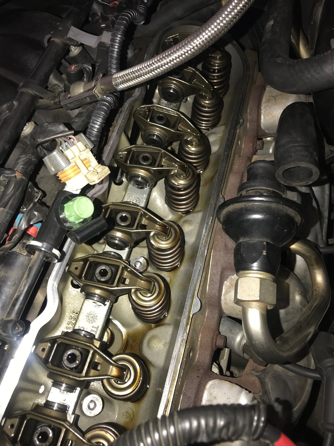

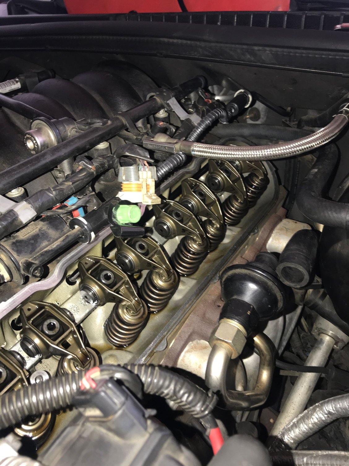

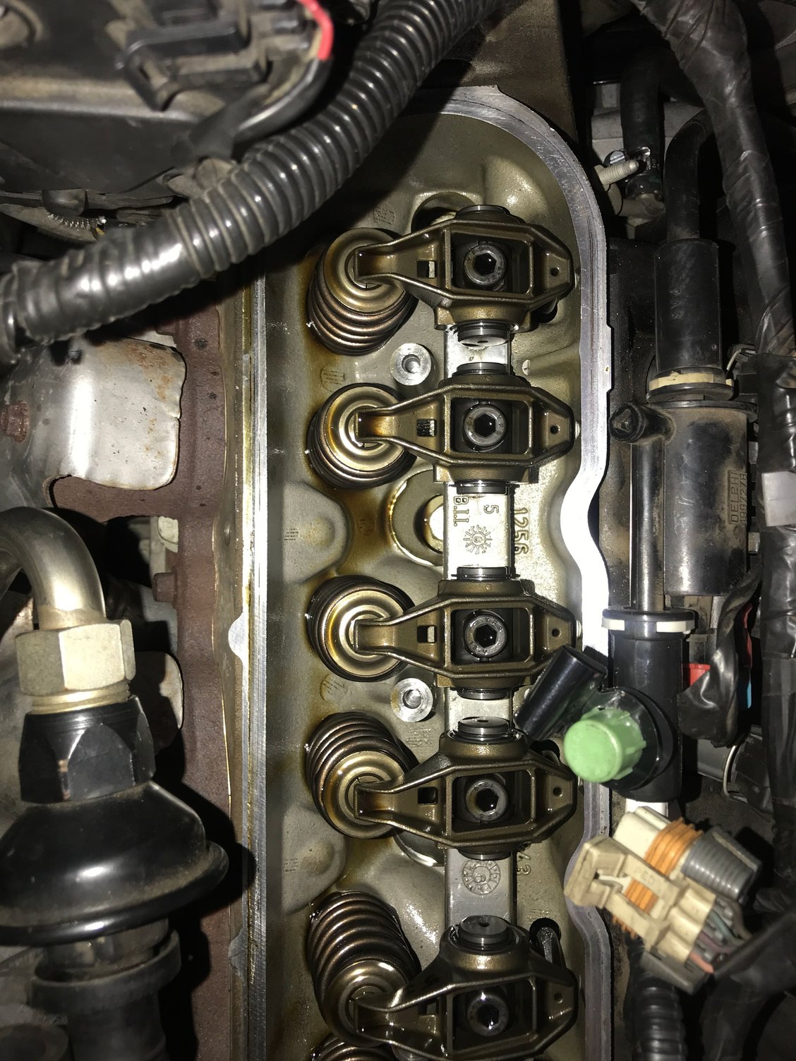

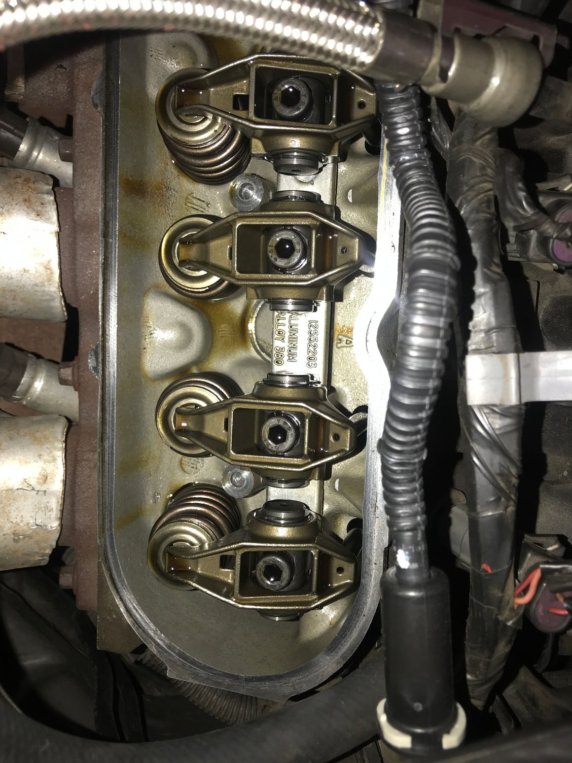

I pulled the valve cover and the rockers/valve springs look healthy. Here are some pictures.

since you had the rockers off have you checked the torque to make sure none of them came loose?... you can also start the engine without the valve cover on and see if anything looks out of the ordinary
All of them were snug and secure, valve springs also. I didn’t start the engine but that’s definitely good to know for the future.

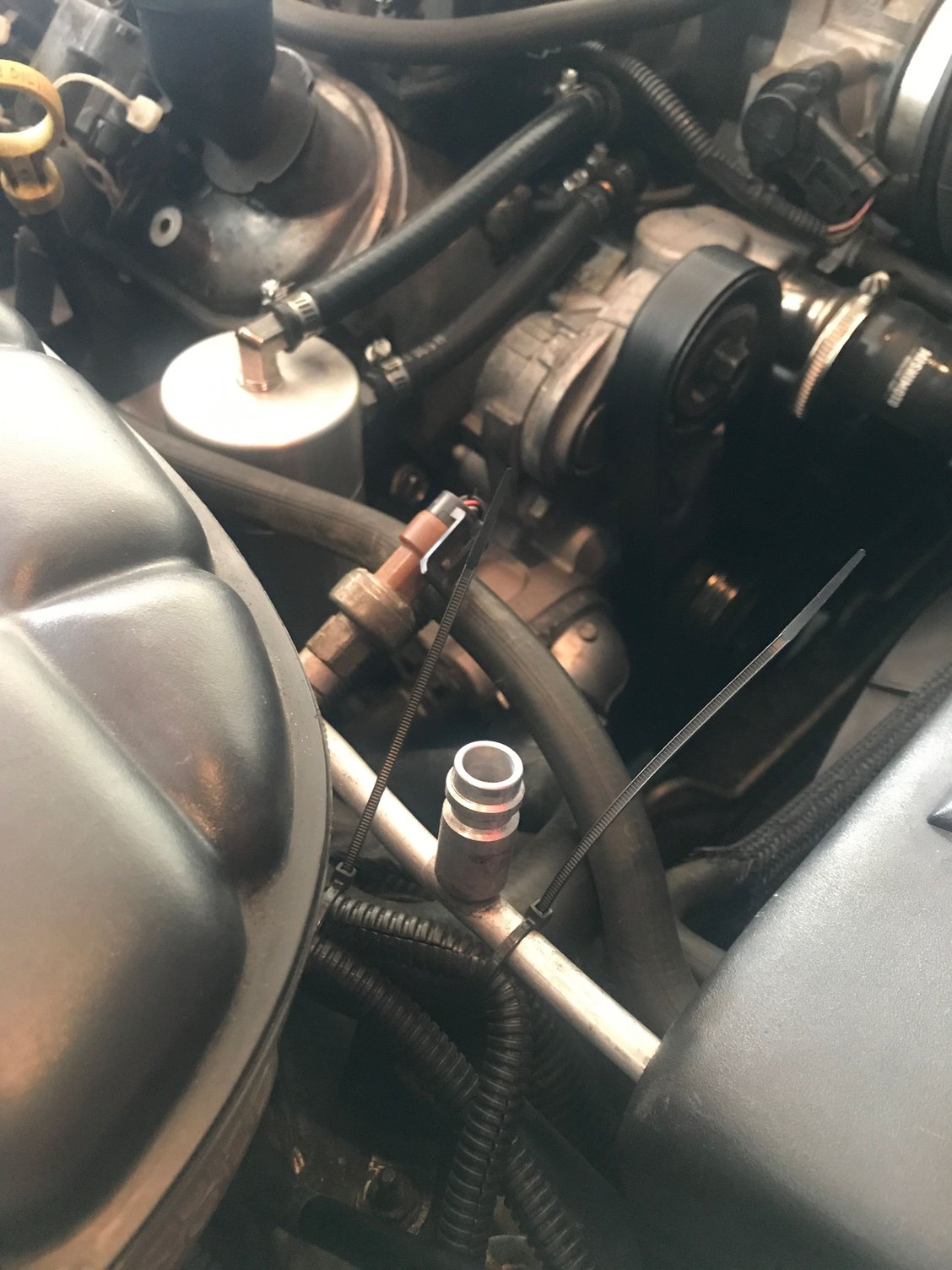

I now seem to hear the noise on both sides of the engine, I can’t pinpoint the sound. I purchased a mechanic stethoscope and it’s not doing much good — I have no idea where this noise is coming from.
I noticed that one of the caps from my AC condenser line is missing. Any chance it’s somehow made it’s way into the crank area and is bouncing around?
Should I be worried to drive it with this noise? I’m considering taking it for a spin to see if the noise lessens, gets worse, or goes away — but obviously don’t want to damage my car.
