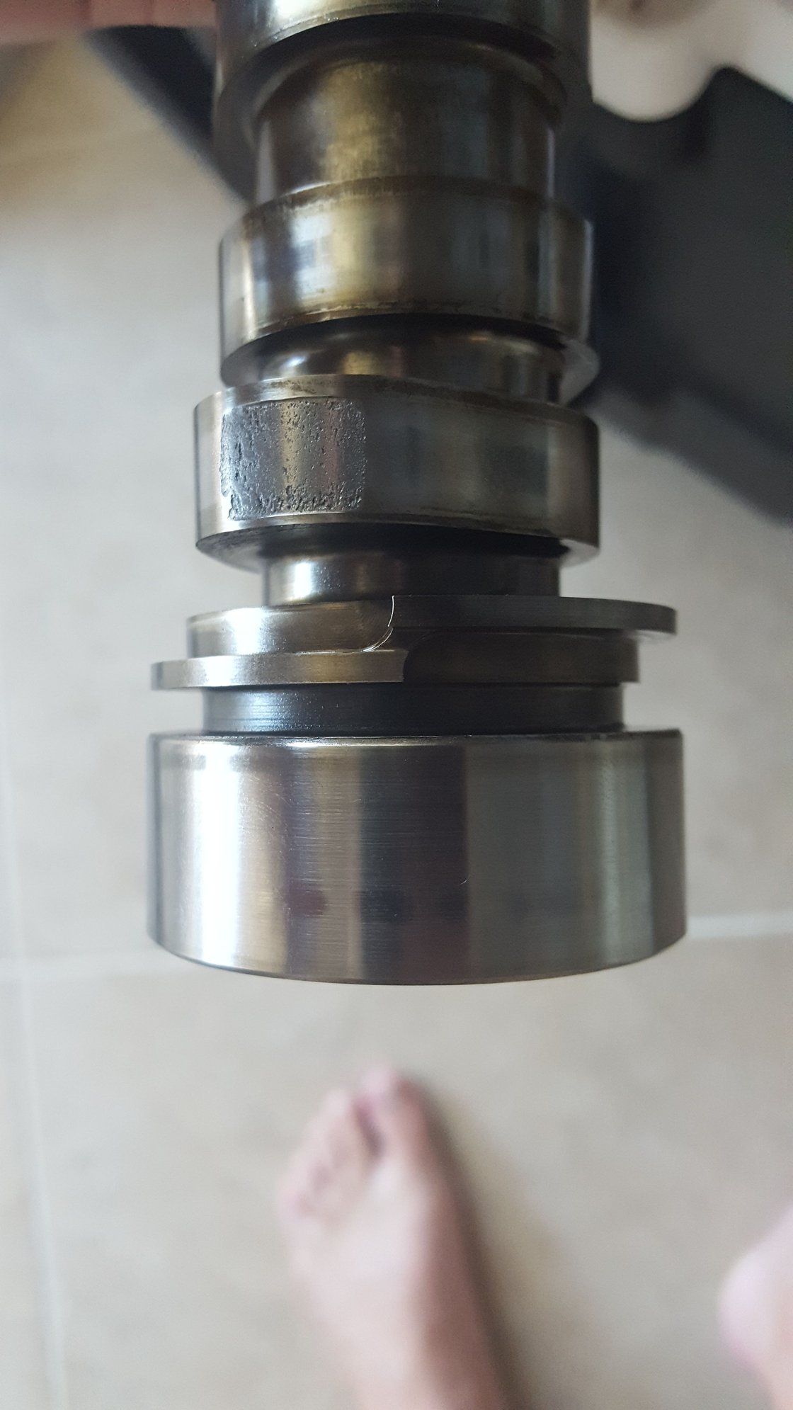

I'm seeing the knock in a log. (HP tuners)
looking at the stock cam that came out, the lifters deffinetly need to be replaced.
Not sure why I didn't catch it during the cam swap.

If you did not swap the lifters you certainly should, I would likely replace the new cam as well.

Ive only put about 200 maybe 300 miles on the new cam with the bad lifters that caused the wear in those pictures. I'm hoping I can just replace the lifters and run it without touching the cam again.

Swaped out the lifters, it must have been an imperfection in the casting when GM made the cam. All the stock lifters looked like new. No noticeable wear.
