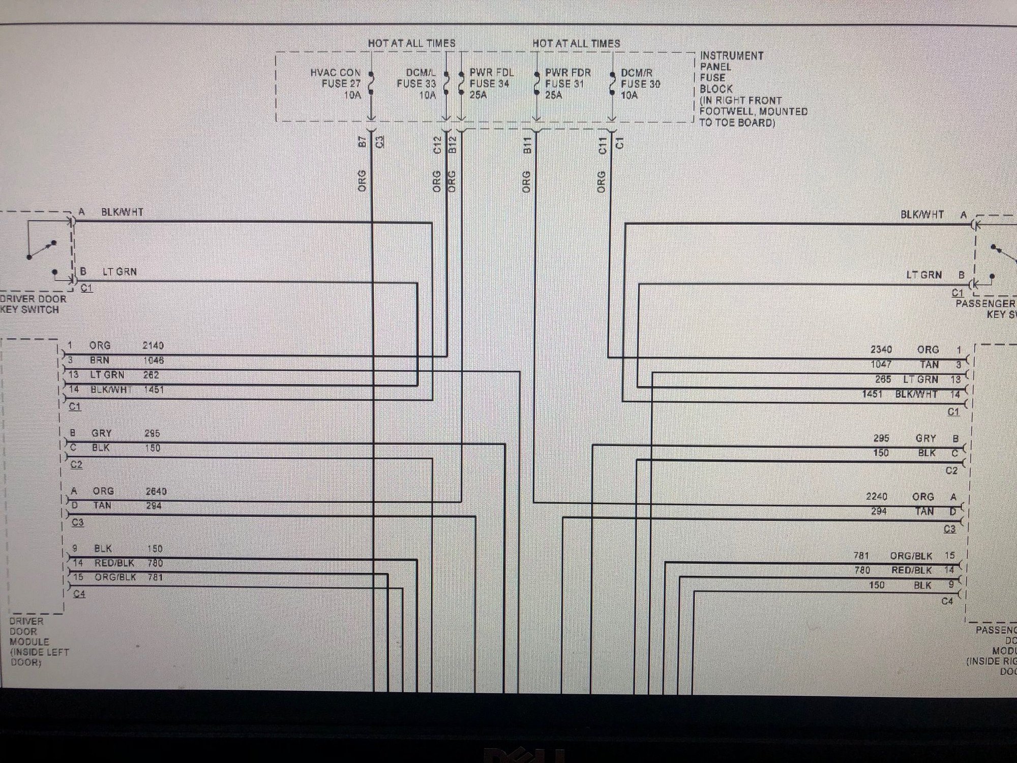

The 82,and 84 are for the LDCM (left door control module "Battery" 1 and 2 fault) and the 83 is the RDCM (right door control module "Battery" 1 fault)... has the battery died lately ??...I'd clear the codes and see if they come back...each of the door modules
have 2 main power feeds and a ground hence "Battery 1 and 2" ....the Battery 1 is the LOW power feed (low AMP stuff) and the Battery 2 is the HIGH power feed (high AMP stuff). I'd make sure your battery and charging system is good....you may have to check the power feeds to both door modules anything between 9-16 volts is good as far as the door modules are concerned !!...good luck !!
