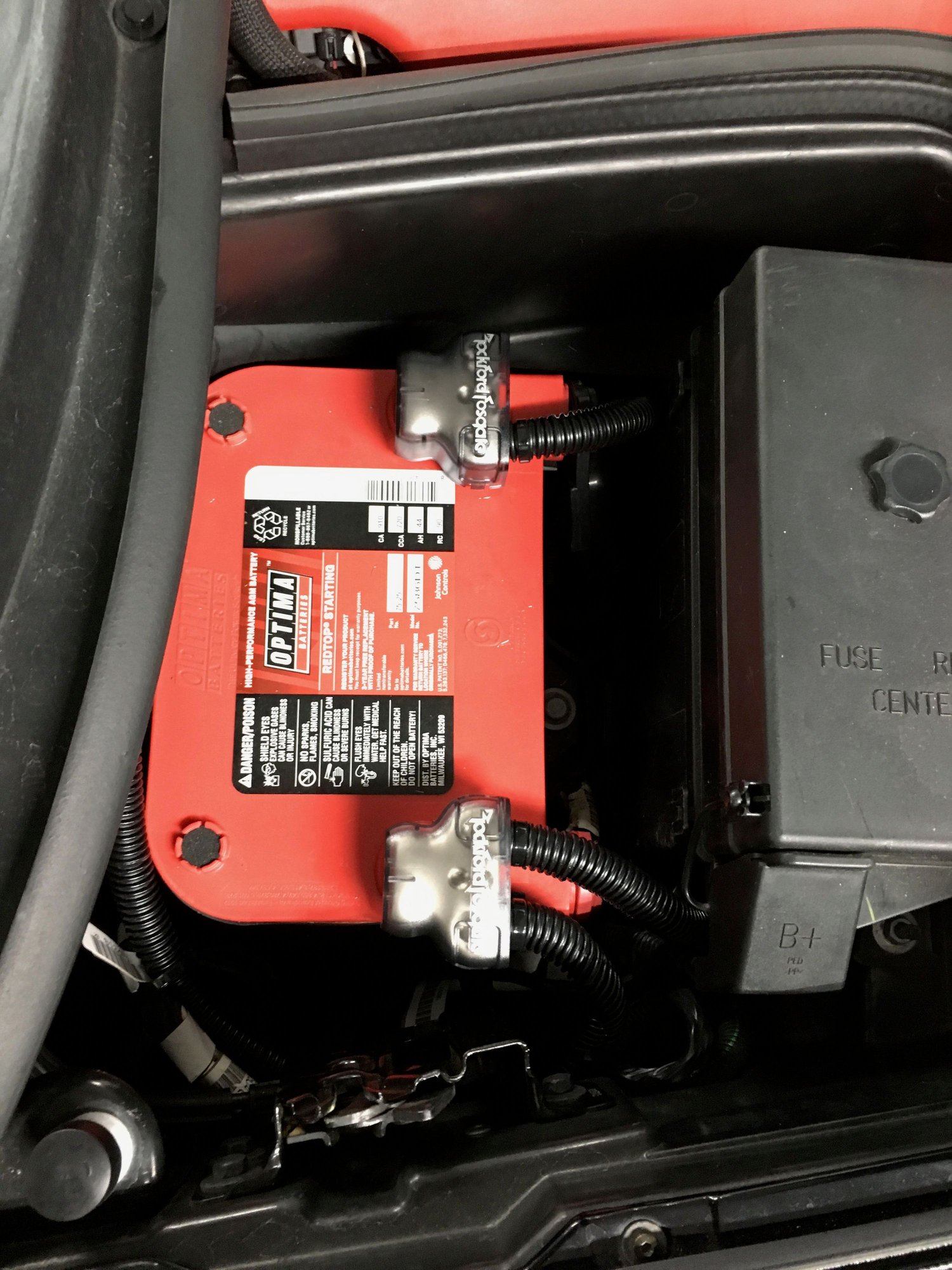

Sometimes you need more options than most standard batteries have available. In the attached pic: Side terminals for OEM wiring, top terminals for stereo. I'm one of the Optima people (good experiences), but I like other batteries as well for my other applications, and I do own a Walmart battery, as well as a few of the auto chain store batteries. As a matter of fact, my Kubota diesel has a chain store battery in it, sits all winter not on a tender, and cranks first time every time. In my experience, most batteries are good (enough), as long as you get the correct battery for the application, and take care of it. However, if you run a battery down to the point the vehicle won't crank, it's pretty much toast after that, especially if it's more than 2-3 years old. I've never been able to recover an older battery (more than a few years) from dead to where it was reliable again. The Vette lives on an Optima tender, because I like the digital readout that tells me exactly what's occurring at the moment (maybe a bit ****). I have other tenders on a couple of vehicles also, and on some vehicles that rarely get driven, I just disconnect the battery till I need it. I have a 1994 Infiniti that has a chain store battery in it going on 6 years that's never seen a tender, gets driven maybe once every 4-6 months and has never given me a problem, but it stays disconnected till I need it.
Red versus yellow? Think of it like this: the battery is primarily for cranking the vehicle. Once the vehicle is cranked, the alternator is your primary source of energy with the battery being a "buffer." As long as your charging system is up to par (including alternator output wiring), you won't be discharging a battery driving down the road, so deep cycle is not needed for a car. Deep cycles are built to be discharged, then recharged, for certain applications that don't recharge while in use, like a trolling motor on a boat.
