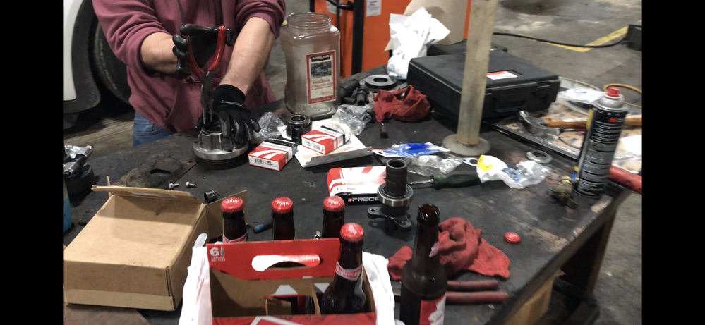

Just helped a buddy with his ‘03z gearbox (70k miles) and he did the opposite. He didn’t do his TT and the front bearing started squealing within 20 miles.
I only charged him a 6-pack for the TT labor. He got a deal.
