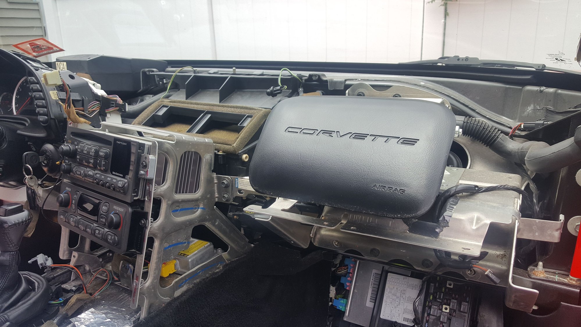

15 year old car.....pull the dash and replace both. You have to pull the dash to replace the right side anyway.
You mean like this ? 🤣

You got it....
