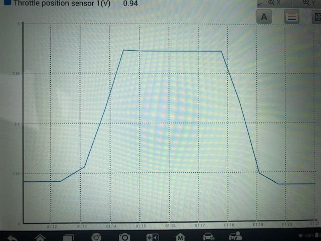

Old Jul 15, 2019 | 08:52 PM
C5 Diag's Avatar
C5 Diag
Moderator, Tech Contributor
Posts: 15,621
Likes: 4,069
From: Cape Coral, Florida
To check the TPS you would look at TPS VOLTAGE with Key on Engine off !!...scan tool isn't the best to find these dropouts...scan tool uses "voltage over frame"...scope uses "voltage over time"...you said MAD sensor...MAF looks good at idle but to really check it's function a volumetric efficiency test at WOT is best...at 3000 RPM the front O's are supposed to oscillate between those numbers so they look good...the rear O2's are more or less "flatline" ...around 600-700 Mv or so...if they oscillate like your front O2 at 3000 RPM after the CATS are hot that's not good...a P0420 is a Bank 1 (drivers side) CAT efficiency DTC and is either a bad CAT so you should worry or an exhaust leak aft of the forward O2 to before the rear O2...there is a test called an "oxygen storage test" that you would do with a scope and some Brake Kleen but I won't get into the details...what do the long and short terms look like at IDLE ??...what do they read ??...I concentrate on the long terms !!...what do they read when at 3000 RPM ??...below is my TPS1 voltage from idle to WOT and back to idle.
