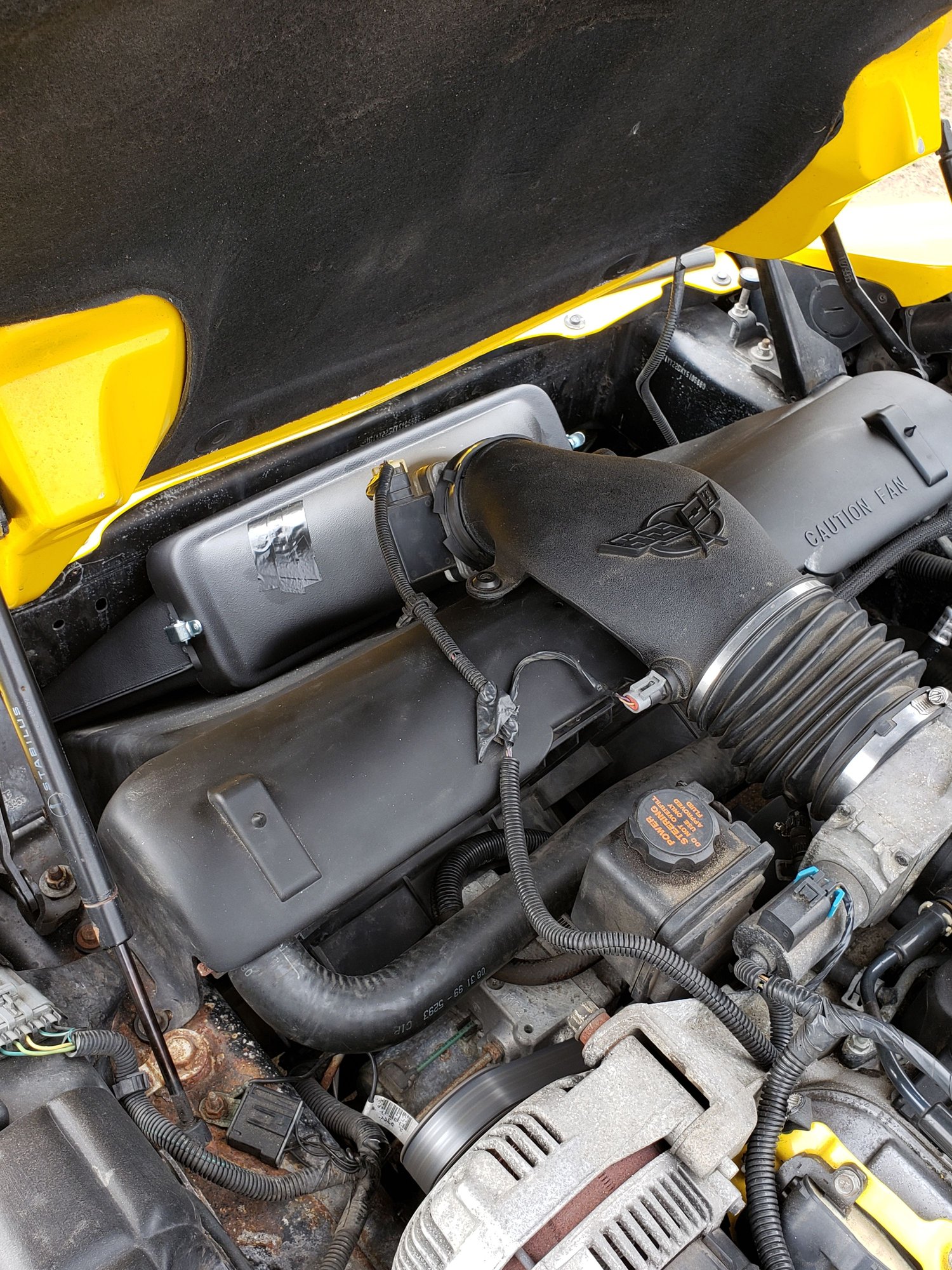

Two things, I agree with the fact you should have installed the hyper flash harness and that would forever eliminate any issues with the 4 way flasher, as it relocates the circuit to a traditional relay nicely tucked under the dash. Secondly, when I first got my 00, I was having turn signal gremlins. It turned out to the be the splice packs located on the frame rails under the hood. They provide ground to different circuits. I believe the drivers side controls the turn signals, but do not quote me on that. Both mine were heavily corroded, so I cleaned each side up. doing that along with now having a hyper flash harness, I no longer have any issues. Keep us posted.
Splice pack is located just below the elbow in the upper rad hose in this picture.

I cleaned the ground tabs on both sides of the car, coated them with dielectric grease, remounted them, no luck...
HVAC still flashes when the fog/park/head lights are not on. If i turn on the left side turnsignal, the right side will pulse slightly, same in the other direction...

Did you check the grounds on the frame rails under the hood?

Meaning, did you take apart the splice packs and clean the connectors?

I tried to find you a link on cleaning them, but just use a small flat head screw driver to remove the end of the splice pack. They're generally pretty crusty when you get them apart.
