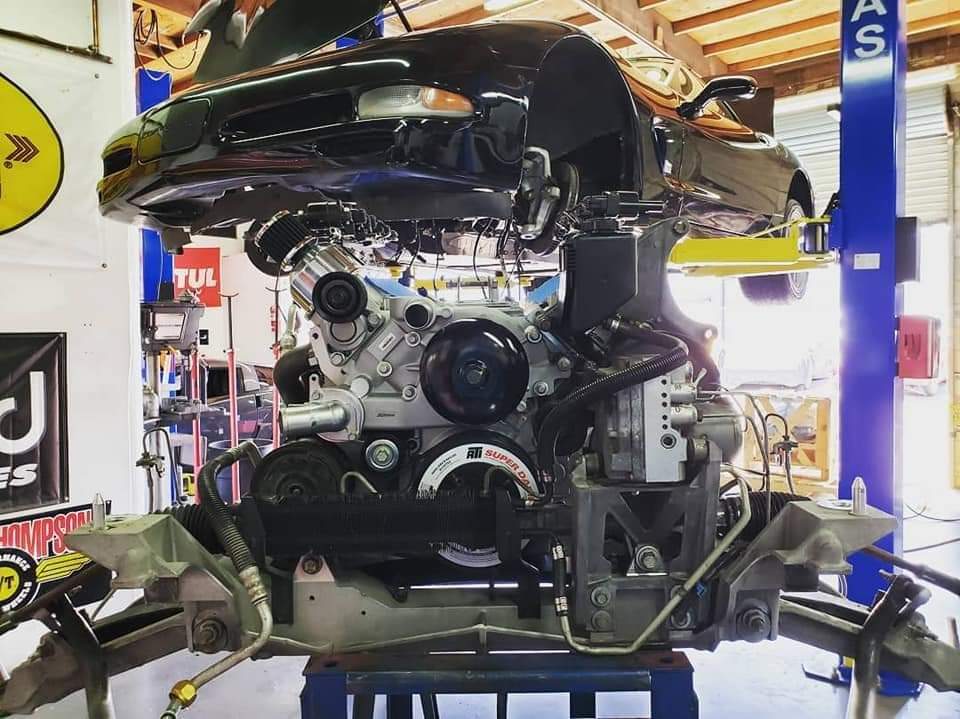

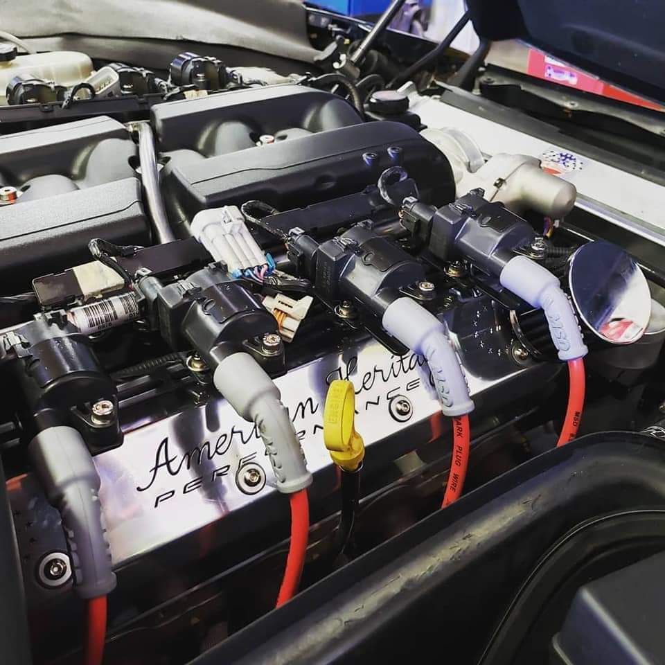

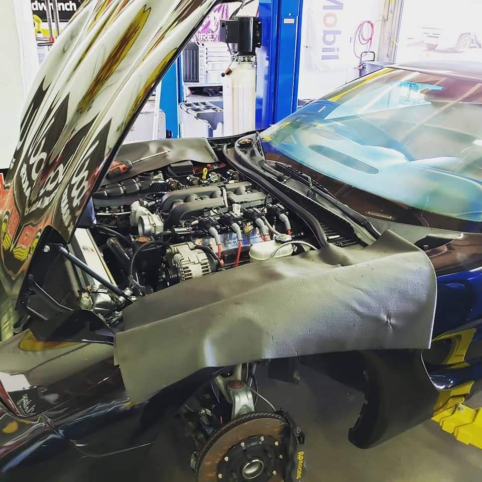

AHP has been wrenching on this Archangel build for some time on my C5 FRC and it is almost done !
434 Archangel Heads & Cam (.720 lift)
LGM Longtubes
AHP Portd MSD
4:10 gears
AP Racing Brakes
Mcloud RXT
Tight fit ! There are some component details in the c6 zo6 forum.
https://www.corvetteforum.com/forums...-and-data.html

434 is your displacement?

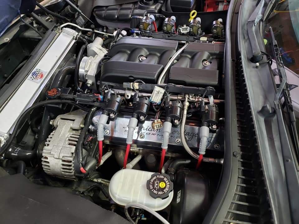

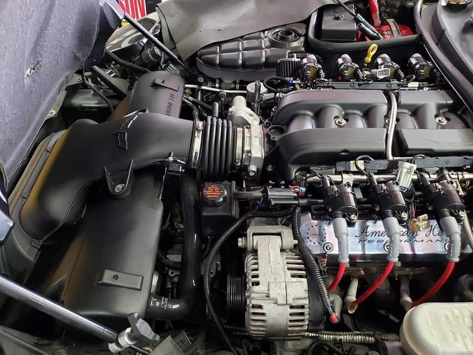

Nice build, does that MSD intake fit without cutting the cowl?

Yes a 434 Darton sleeved over-square 4.155 holes/4” stroke.
Hinson mounts help fit the MSD inside.
